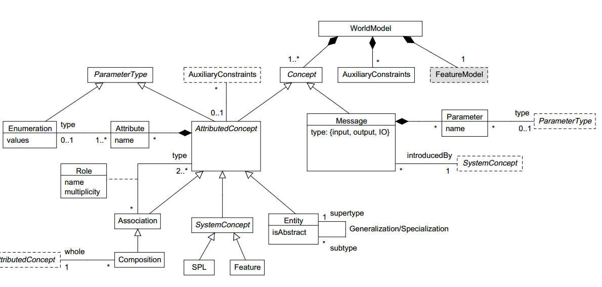

Given the meta model attached below, which way of implementation is correct for the Message class.
1)
Concept:
message=Message |
attribuConc= AttributedConcept
OR:
2)
Concept:
name or whatever attribute
Message returns Concept:
So, the difference is using "return" keyword which is used for subtyping or using message inside concept. Using (1), the generated Java code creates a class concept which HAS message attribute. but using return statement (2) generate a class Message that extends Concept.
Thanks.
Parsa

Do you know if we have an attribute (let's say name) in Concept, and Message also inherits this "name" attribute form Concept, then from what I can see we need to declare name in the Message and not in Concept. Because concept here is just a transient element, right ? I tried having name for both Concept and for Message. In the generated ecore file it adds name attribute for both elements. However, since it is a inheritance, only Concept should have it and inherited Message can have name attribute by inheritance... What do you suggest ?
I want to end yup with generating an ecore file like below:
Concept
-name: EString
Message->Concept
-a1
-a2
So, Message still has name attribute by the definition of inheritance. Not sure, how to do in XText.
Bests,
Parsa
