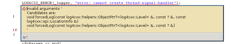

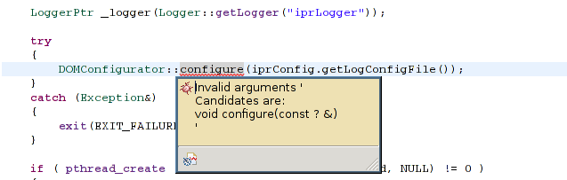

I've Eclipse Mars (4.5.1) installed on my PC and I just made an Eclipse project (CDT C++ project / CMake) .
In this particular project, I have used Apache LOG4CXX library in my code and the problem that I have is that Eclipse always display an annoying errors about 'Invalid arguments' for different functions and macros of Log4cxx. (please check the attached scrshots)
Could anyone please help me on this problem ? any workaround ?

A question mark is appearing where a type name would be expected. Your index is likely messed up. Try rebuilding it using Project ==> C/C++ Index ==> Rebuild. It's also possible that you have unresolved includes. Try Project ==> C/C++ Index ==> Search for Unresolved Includes and see if it produces anything.
