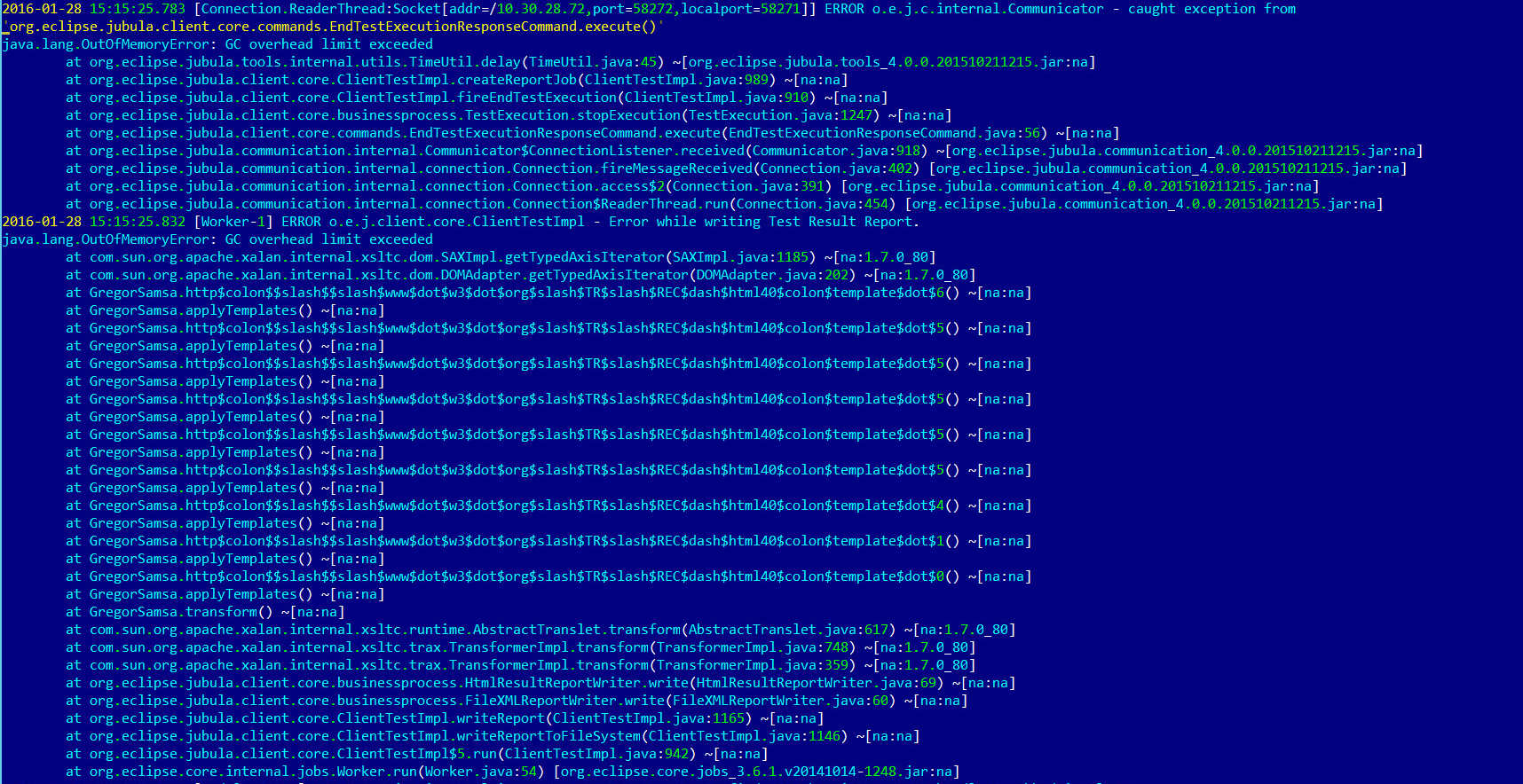

Re: Testexec - report only failed tests [message #1722211 is a reply to message #1722153] Wed, 03 February 2016 07:15 Go to previous messageGo to next message
Stack trace from client.log:
index.php/fa/24873/0/
Here is statistic of testset (please note, it does not fail with OOM now. When it failed there were more executed CAPs (run time was one hour more) and lots of screenshots since many tests were failing. When OOM occurred xml report was created (~130Mb) and HTML report with zero length):
