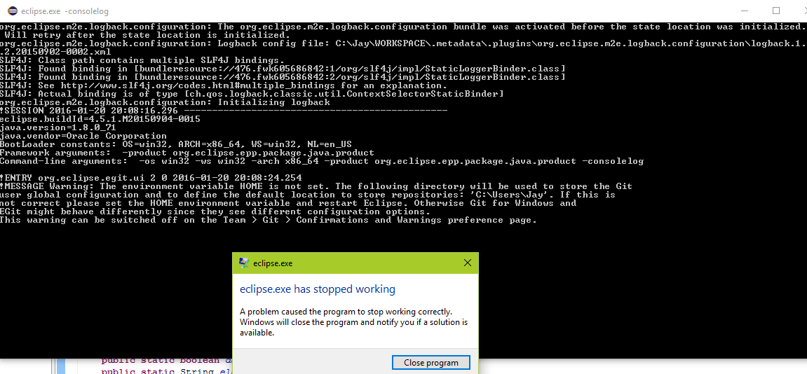

Re: Eclipse Mars - Windows 10 - Crashing [message #1720786 is a reply to message #1720785] Wed, 20 January 2016 20:33 Go to previous messageGo to next message
So just crashed again with nothing in the consolelog. Bummer.

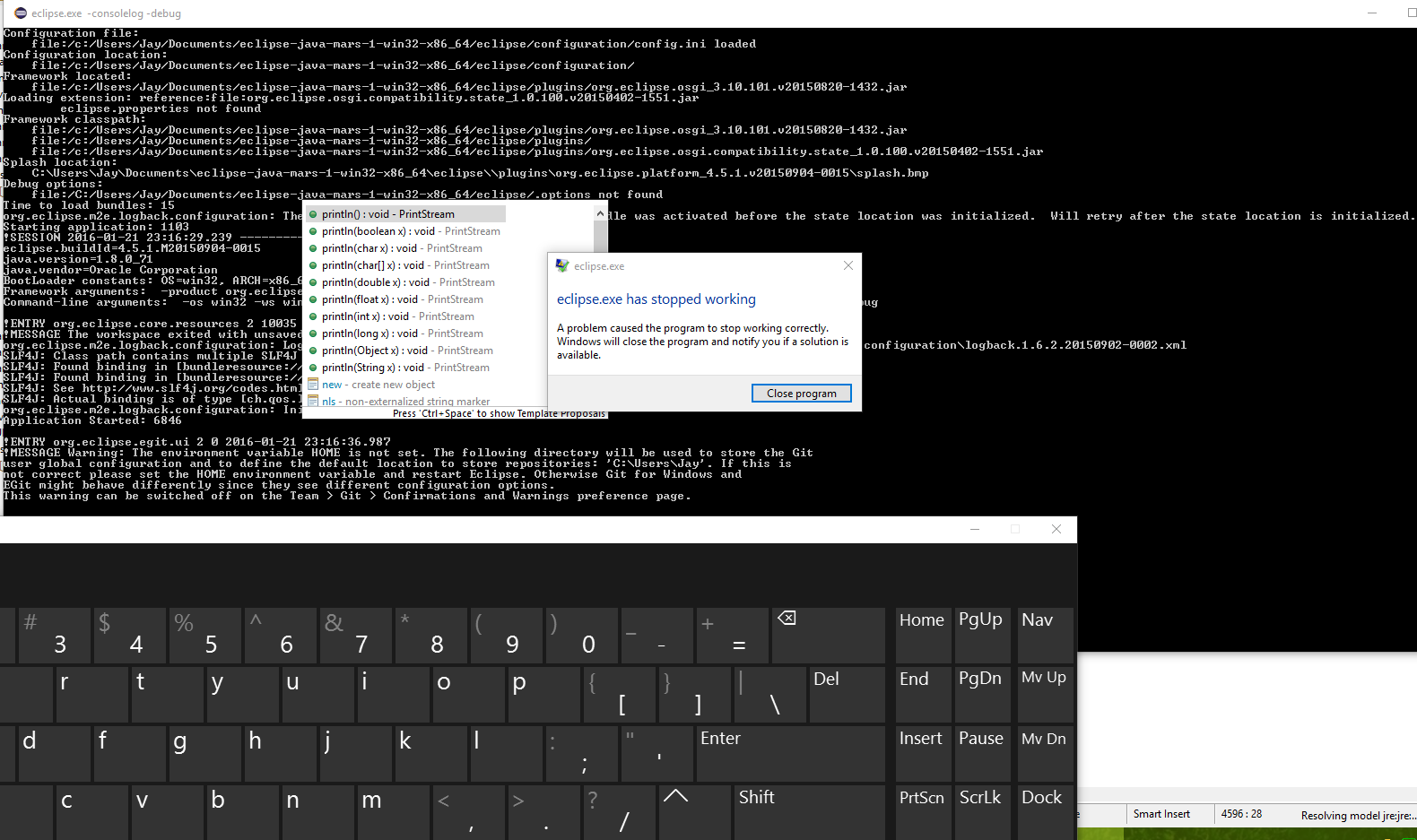

I was unable to get a stack trace because there is no break key on my laptop or the on screen keyboard that ships with windows 10. I tried ctrl + pause with no luck.
Eclipse(or whatever) just crashed again. When I was typing 'System.out.println' as you can see in the code completion screenshot.
index.php/fa/24720/0/
