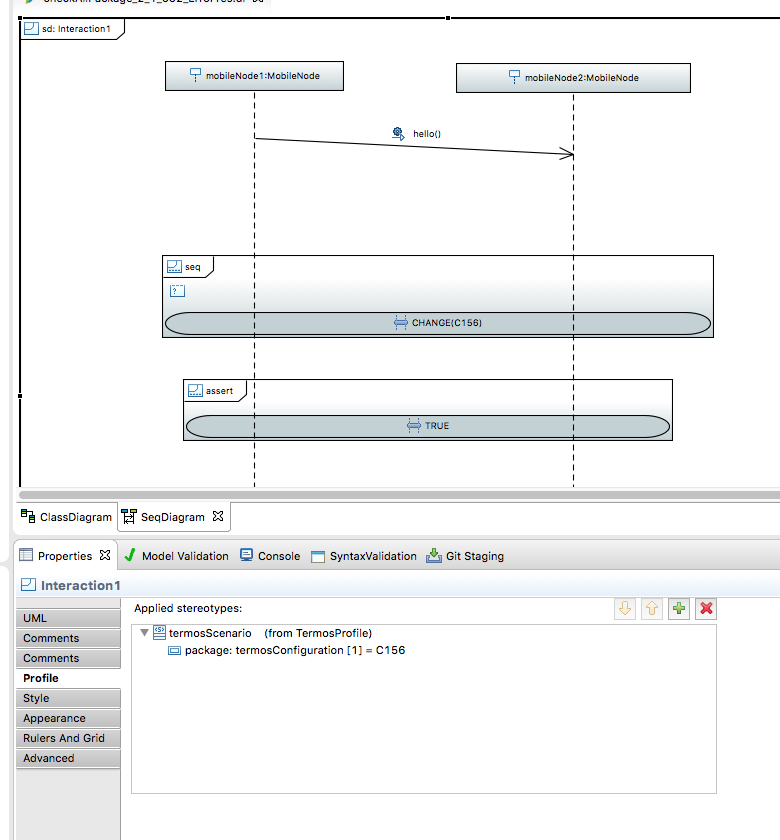

Thank you very much for your answer.
In fact, the stereotype is applied to the interaction diagram (see the screenshot of papyrus).
When I search the stereotype applied to the interaction I don't get any result.
I don't understand how to get the aplied stereotypes ?
Sincerely
Jean-Marc
> Sincerely
> Jean-Marc
