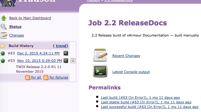

sure: attached screenshot shows the status of my job. only the last successful job, before the host was moved, was 71, not 65 as shown. jobs 70 and 71 were both tagged "keep forever" and provided with a description.
my assumption is some metadata got clobbered when the host was shutdown. the hope is i can manually recreate it.

Re: Missing Jobs [message #1720019 is a reply to message #1720017] Wed, 13 January 2016 12:50 Go to previous messageGo to next message
In the job folder you would see a _runmap.xml. You can delete or rename it and start Hudson again. Hudson would recreate that file. Hope that fix this issue.
Re: Missing Jobs [message #1720022 is a reply to message #1720019] Wed, 13 January 2016 13:06 Go to previous message
fabulous! that worked. thanks for your help.
