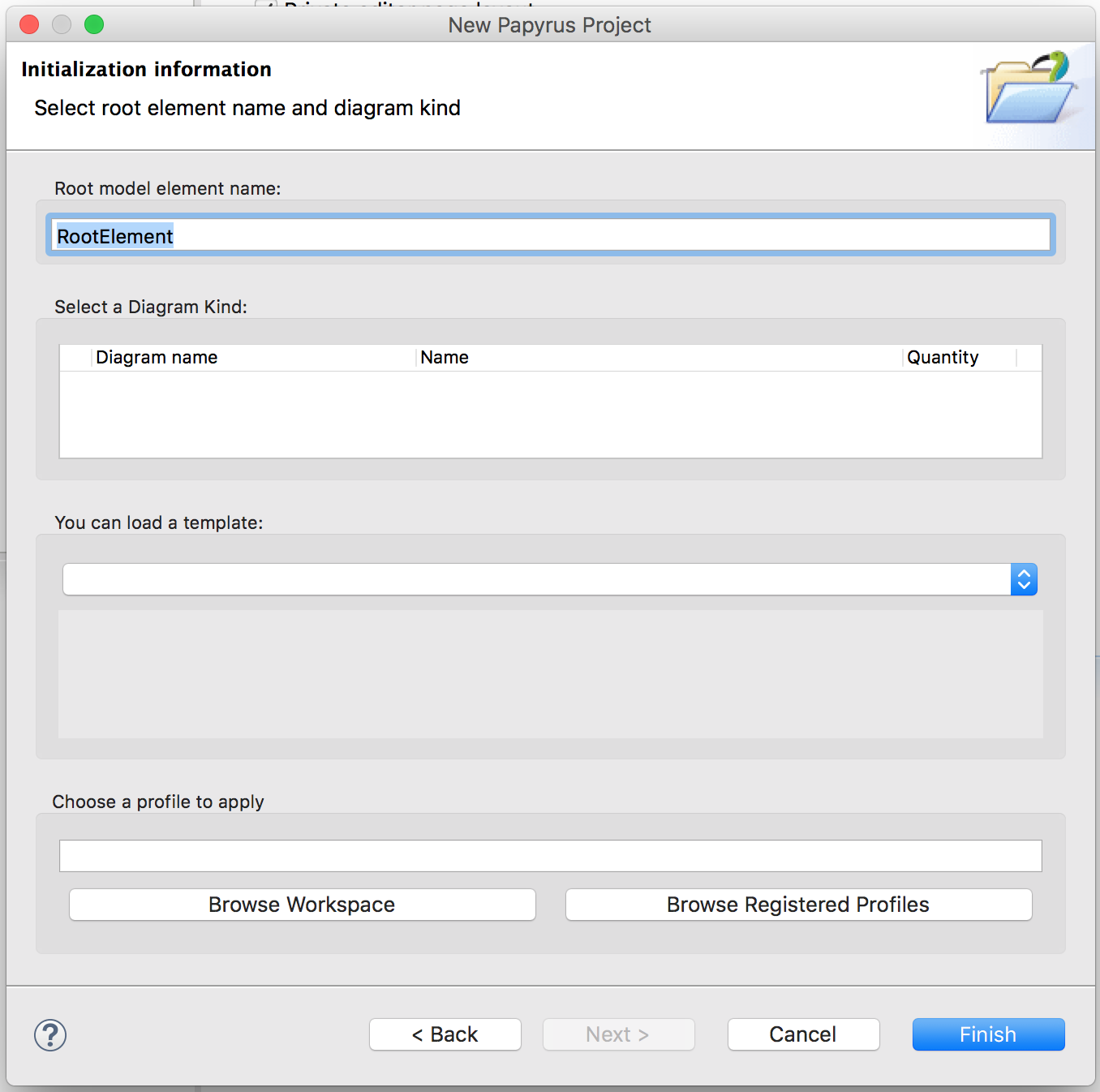

Hi Camille,
I am running into some problems with my custom diagram for DSML. How do I display my custom diagram in the "Select a Diagram Kind" editor? I have implemented a viewpoint extension with a Diagram and a View Category but when I try to create a papyrus project, my custom diagram is not listed in the editor.
