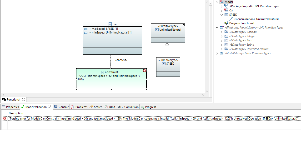

I am trying to create my own Primitive Types by inheriting from the ones defined in standard UML Primitive Types Library. Then I use my defined types to define the properties of my classes. This seems to be accepted by UML, as I don't have any validation errors.
see attached image, for a small example.
index.php/fa/24531/0/
The problem arises when I write OCL constraints that uses these properties. If the type of my property is one in the standard UML library (say Unlimited Natural) I can use operators defined in the standard OCL library ( <, + , ...) . However, if the type of the property is my own defined Primitive type I get a parsing error, because the operation is not defined for my type.
Digging the code of the UML2Pivot transformation, I have managed to pinpoint that the problem is the generalization hierarchy is only copied from the UML model to the OCL Pivot model in these two cases :
- for Classes (in UML2PivotReferenceSwitch.caseClass()
- for interfaces (in UML2PivotUseSwitch.caseInterface()
But the generalization hierarchy is never copied for PrimitiveTypes.
In the UML metamodel the generalization hierarchy is defined in class Classifier (property generalizations). In the OCL Pivot metamodel the generalization hierarchy is defined in class Type (property superClass).
In UML ,PrimitiveType inherits indirectly from Classifier. In OCL Pivot , PrimitiveType inherits indirectly from Type. So, in principle, it may be possible to recreate the hierarchy.
So the question is whether my usecase is a valid? is it worthwhile to try to make this work (as from my initial investigations seems to be possible)? or it is just a corner case of UML/OCL that will lead to unanticipated problems,

Re: UML-OCL : Inheriting operations from primitive types in standard UML library [message #1719416 is a reply to message #1719412] Thu, 07 January 2016 13:25 Go to previous messageGo to next message
PrimitiveTypes are primitive so I cannot recommend extending them.
In order to make PrimitiveType an extensible concept for use with OCL,
the OCLforUML profile defines <<Integer>>, <<Real>> and other
stereotypes that can be applied to your DataTypes. See
http://www.slideshare.net/EdWillink/the-oclforuml-profile
Unfortunately the profile lacks the extra Papyrus registration in Mars,
so you may need to use the UML Model editor to apply it. Recent versions
of Papyrus have the extra registration.

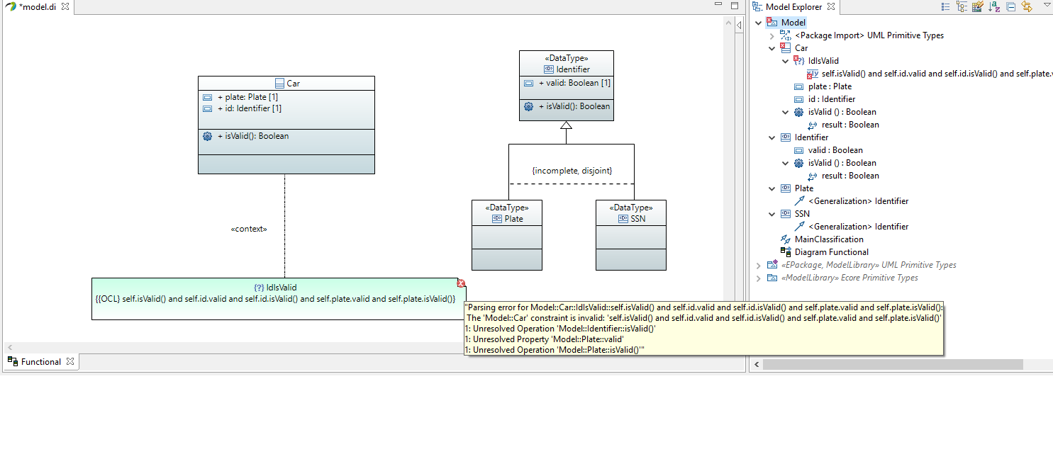

For structured data types however, I have found similar problems (see attached image):
index.php/fa/24545/0/
Using properties defined in DataTypes in OCL constraints works, but they are not inherited. For query Operations (defined or inherited) of DataTypes, they are not translated to the pivot model.

Re: UML-OCL : Inheriting operations from primitive types in standard UML library [message #1719531 is a reply to message #1719496] Fri, 08 January 2016 11:36 Go to previous messageGo to next message
Insightful help is very welcome.
Rather too much of my UML knwoledge was derived from the UML < 2.4 Basic
Package which was much more restrictive. I've gradually relxed
inappropriate restrictions.
I think you'll find that DataType inheritance is fixed by commit
"[472469] Convert DataType generals to superclasses in UML2AS" in Mars.1.
UML2Pivot is now UML2AS and is hopefully going to move from ad hoc
manual Java code to an OCL-defined autogenerated Java code shortly.
Ed Willink
