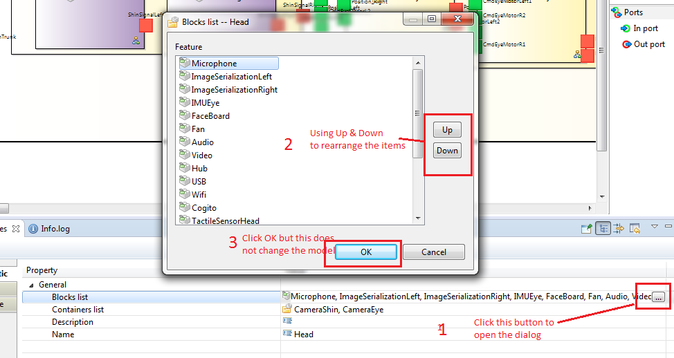

Hi Steve
Yes, you are right, I attach here an image so the problem could be illustrated more clearly.
index.php/fa/24645/0/
Let's look at the Property view, we have 4 properties: Blocks list, Containers List, Description, and Name.
If you want to change the order of these 2 lists, you can do following the steps as illustrated in the picture. However, when you finish by click on the OK button:
- It seems that the data in memory is not updated to the real model
- You can see the order of elements are changed, but if you close the diagram and reopen it, everything returns to the moment before.
- As a result, you don't see the Save icon is changed, a signal to show that the model is changed, which does not happen when you modified the text properties such Description or Name.
The class of the dialog when we click the "..." button is FeatureEditorDialog.
Hope that you can see the problem in this situation.

Thanks for the explanation and the screenshot. Can you look at the code
executed by the Ok button on FeatureEditorDialog and check that it is
executed using the editing domain of the Sirius Session?
It should probably look like this:
Session session = SessionManager.Instance.getSession(selectedElement);
session.getTransactionalEditingDomain().getCommandStack().execute(new
RecordingCommand(session.getTransactionalEditingDomain()) {
protected void doExecute() {
// Update list order
Steve
