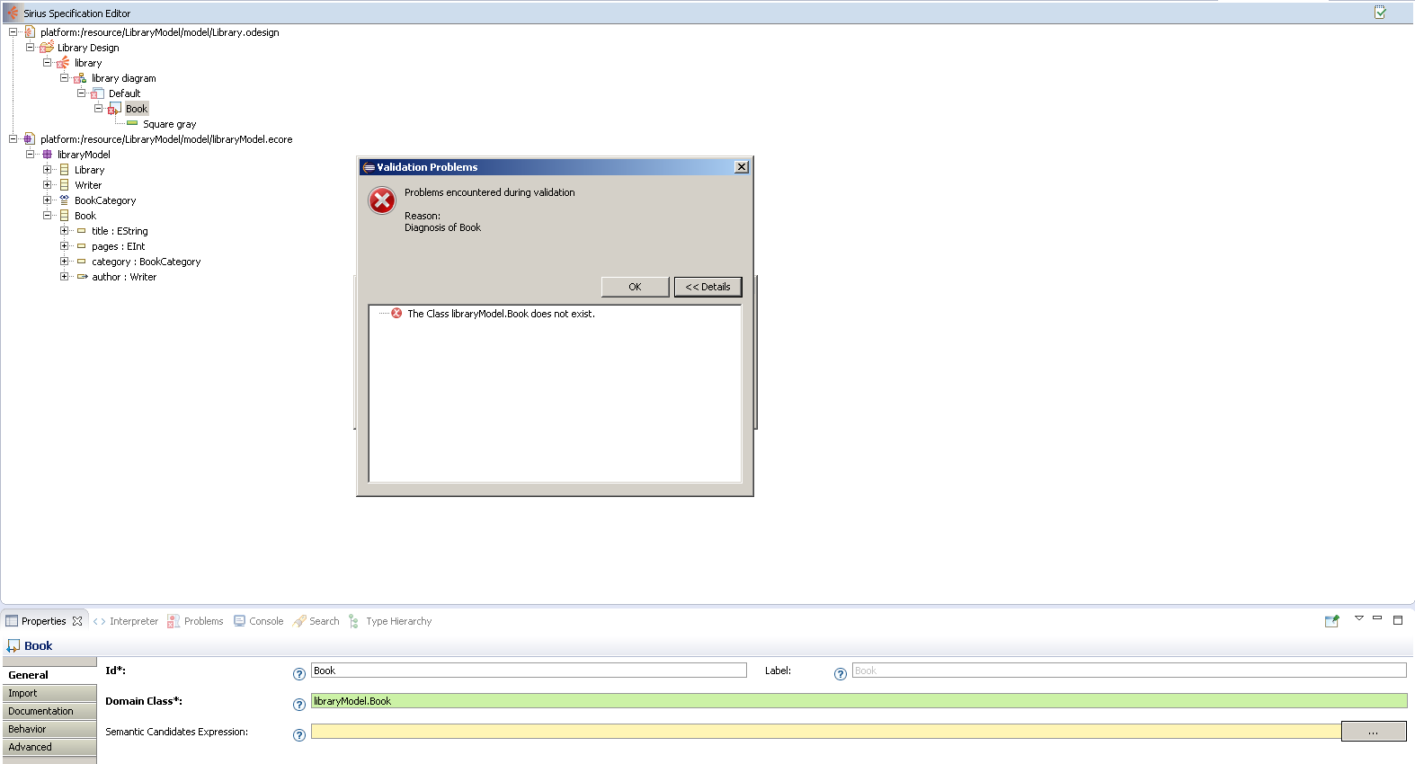

I am writing a research paper and I need to confirm something. Some editors, such as the reflective EMF tree editor, are able to work with Ecore models that have no generated model code. I want to know if this is possible with Sirius, or if the model code generation step is necessary.
I know it is possible to load an .ecore file from the workspace using the 'Load Resource' action, but it throws an error telling me that one of the classes does not exist:
The error goes away if I generate model code and load it into a new Eclipse workbench.
I am unable to find any information on whether this is supposed to be possible or not. If anyone knows for sure or has a source confirming whether it is, then it would help me out a lot. Thanks.

On 05-Jan-16 15:04, Oddvar Hungnes wrote:
> Hi,
What happens if you deactivate live validation and try to run it?
Felix

Le 05/01/2016 15:04, Oddvar Hungnes a écrit :
> Hi,
Hello
You need to generate java code to open an EMF model with your own type
EMF provides the Reflexive editor to edit .ecore models. If your ecore
model contains only instance of the Ecore metamodel you should be able
to open it without error with the reflexive editor

Re: Is it possible to use Sirius without generated java code? [message #1719427 is a reply to message #1719364] Thu, 07 January 2016 14:58 Go to previous message
Felix Dorner wrote on Thu, 07 January 2016 09:50
Felix
It doesn't show up in the Viewpoints Selection dialogue so I was unable get any farther than this.
Laurent Fasani wrote on Thu, 07 January 2016 13:09
Laurent
Thanks, that's good to know.
