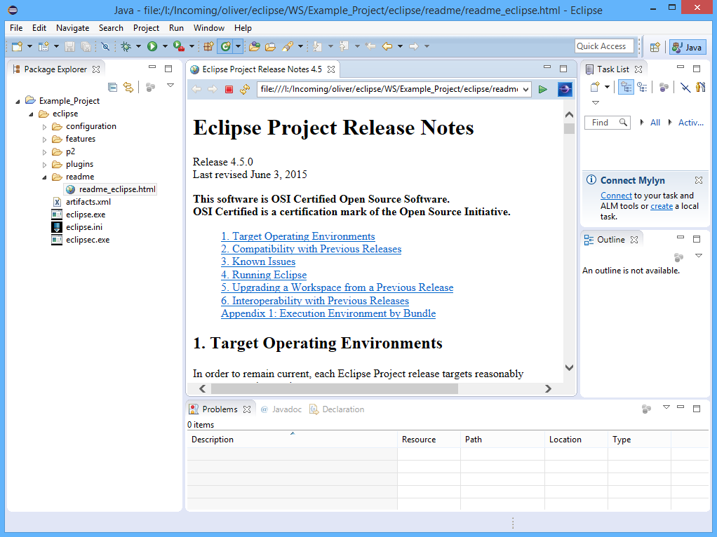

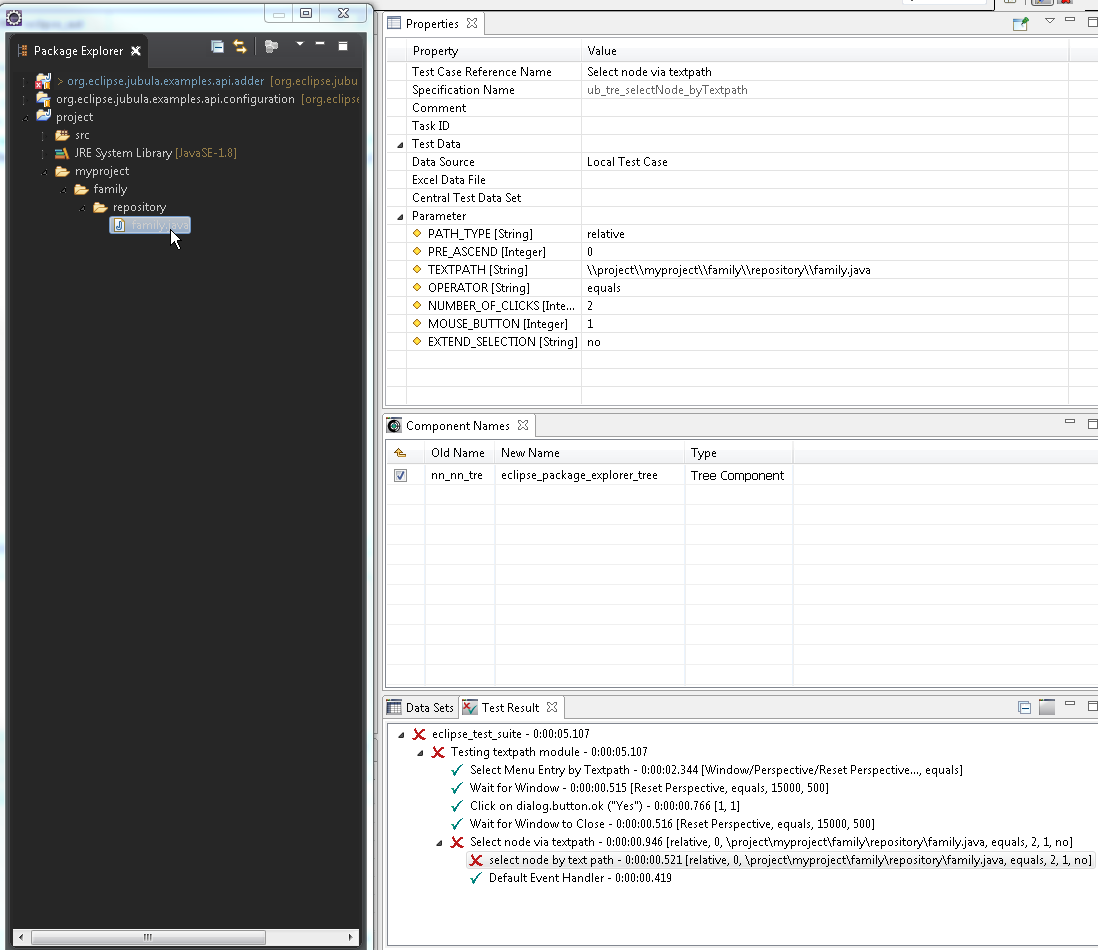

I was using the predefined Select Node by Textpath test case for eclipse mars package explorer, but couldn't get it right...
TEXTPATH[String]: \\project\\myproject\\family\\repository\\family.java
i was only able to expand the project node, i want to reach the family.java class file and open it
[please see image]
anyone who can help pls.
tnx

I want to open the family.java file [please see image] with the predefined Select Node by Textpath test case. Meaning I want to walk down the tree and open the family.java file.
Yes I have read the documentation. Wasn't successful.
I was successful trying to use the Select Node by Indexpath testcase though.
tnx

Re: Select Node by Textpath [message #1719127 is a reply to message #1719113] Tue, 05 January 2016 09:09 Go to previous messageGo to next message
This is strange, it works for me using
- Jubula Stand Alone Version: 8.2.0.021
- Eclipse IDE for Java Developers, Version: Mars.1 Release (4.5.1), Build id: 20150924-1200 as AUT
Could you please add more Information about your setup, e.g. used Jubula version, used Eclipse version, Test Execution Report, log files...

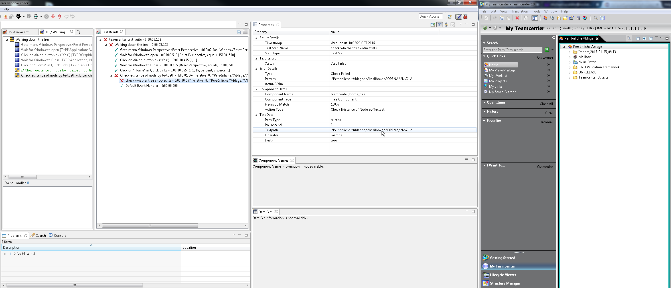

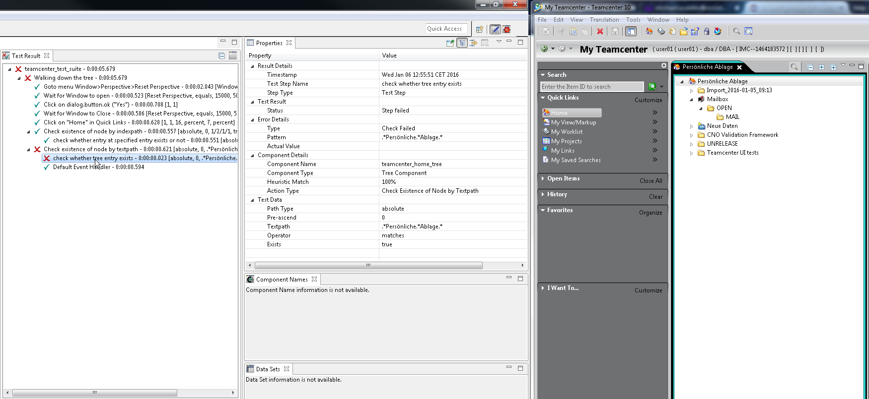

Re: Select Node by Textpath [message #1719200 is a reply to message #1719026] Wed, 06 January 2016 03:03 Go to previous messageGo to next message
Morning,
[please see images]
Toolkit is RCP
Check existence of node by indexpath is succesful (like it was for Eclipse)

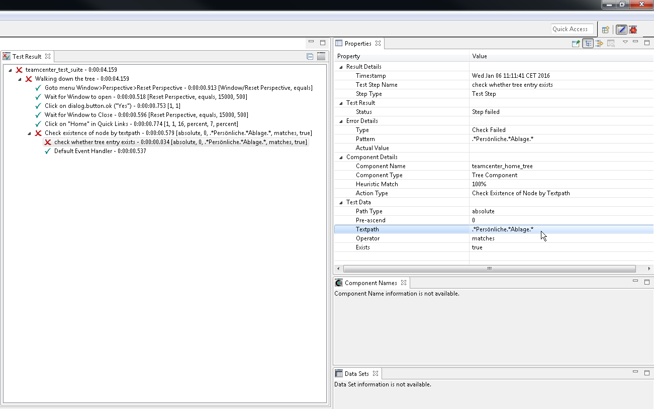

Check existence of node by textpath:
For parameter:
absolute = error + nothing happened
relative = error, but the mouse moved to the tree and the root node expanded only
Tnx for the help

Try "matches" and use RegEx: .*Persönliche.*Ablage.*/.*Mailbox.*/.*OPEN.*/.*MAIL.*
Re: Select Node by Textpath [message #1719212 is a reply to message #1719026] Wed, 06 January 2016 04:37 Go to previous messageGo to next message
still nothing,
i tried it both for relative and absolute
[please see images]
i provided an image of the node i want to access btw
strange but it says that it has an heuristic match of 100%, meaning it recognizes the tree structure right...?
tnx
Re: Select Node by Textpath [message #1719218 is a reply to message #1719212] Wed, 06 January 2016 05:08 Go to previous messageGo to next message

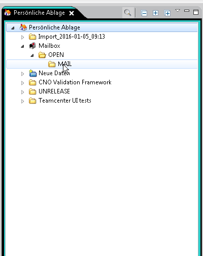

What happens if you only check for the node "Persönliche Ablage"? If this works try "Persönliche Ablage/Mailbox" etc. Use "matches" and RegEx again, don´t use a relative pathtype, this only works if there is a node already selected.
Re: Select Node by Textpath [message #1719219 is a reply to message #1719026] Wed, 06 January 2016 05:16 Go to previous messageGo to next message
Can't find Persönliche Ablage...
[please see image]
Re: Select Node by Textpath [message #1719223 is a reply to message #1719219] Wed, 06 January 2016 06:05 Go to previous messageGo to next message

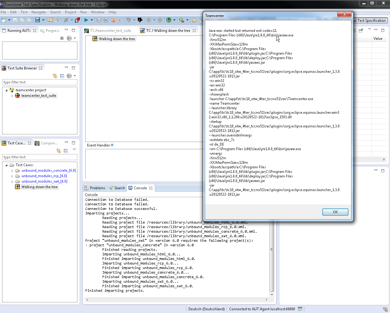

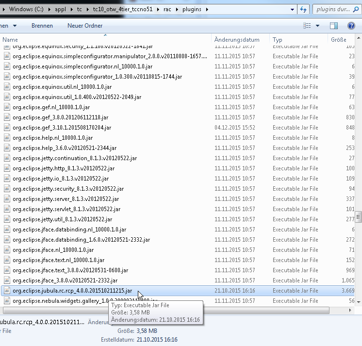

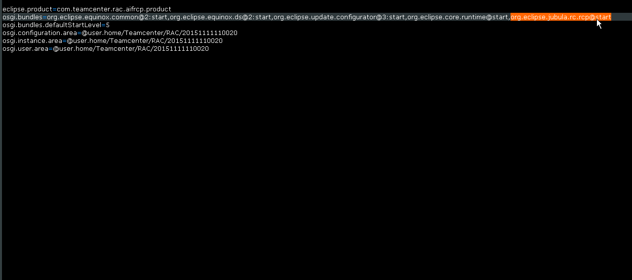

Re: Select Node by Textpath [message #1719238 is a reply to message #1719026] Wed, 06 January 2016 08:36 Go to previous messageGo to next message
i am trying to get jubula running that comes with eclipse...
do i leave the org.eclipse.jubula.rc.rcp.....jar in my plugins folder of the Teamcenter AUT?
How about the org.eclipse.jubula.rc.rcp@start in the config.ini file?
well, i left everything as i would use it with the standalone version. All went fine, Teamcenter started, BUT when i wanted to start the Observation mode Teamcenter just disappeared/crashed? leaving me with th exit code=11
[please see images]
tnx
this is the rc_rcp.log for the crash of teamcenter using eclipse

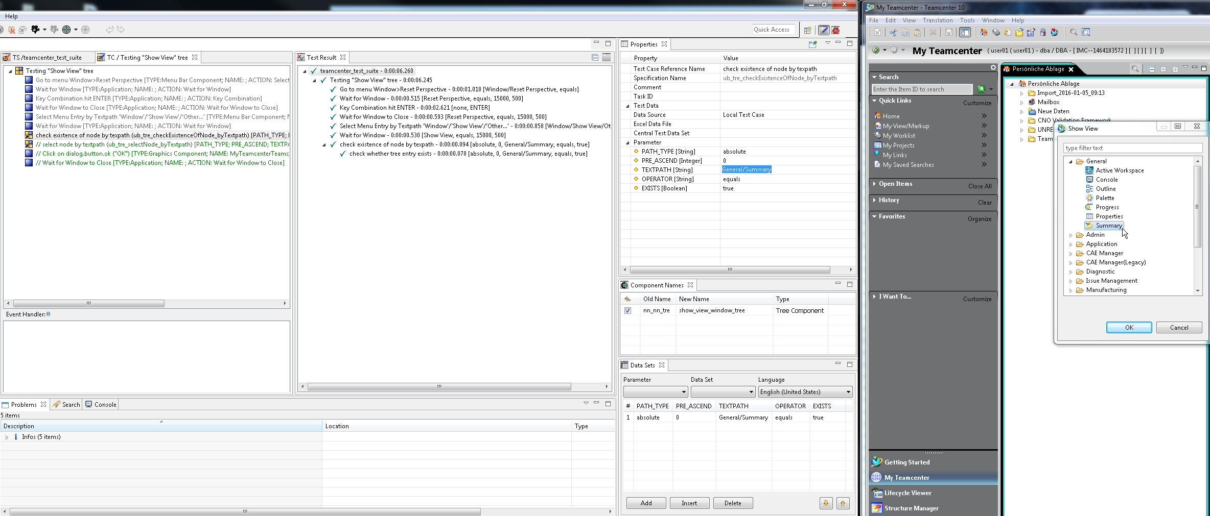

Re: Select Node by Textpath [message #1719663 is a reply to message #1719026] Mon, 11 January 2016 03:50 Go to previous messageGo to next message
Heads up!
Successful testing the Show View Tree in Teamcenter [please see image].
The issue is probably the widgets of Teamcenter, who internally use the Eclipse TreeItem components.
