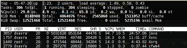

Issue #1: excessive CPU use
There is constant CPU usage. Approx 30-40%. It's worse when Eclipse has focus. Can anybody tell me what it's doing?
EDIT: added this image of top output while Eclipse has focus. As you can see instead of just sitting quietly it's burning almost 100% of the thread time.

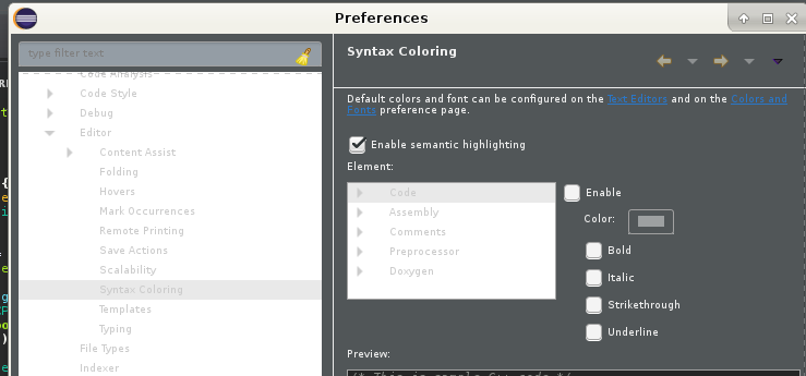

issue #2: colors
I had to import syntax colors from a previous setting. This is OK but seems it should have been unnecessary.
The foreground/background color for many views and dialogs abruptly changed to light gray on white. It used to be white on black. I'd like to change these back to what the previous version had but I can't find any settings to change They are impossible to read.
Here are a couple of examples.
index.php/fa/24426/0/
index.php/fa/24427/0/
