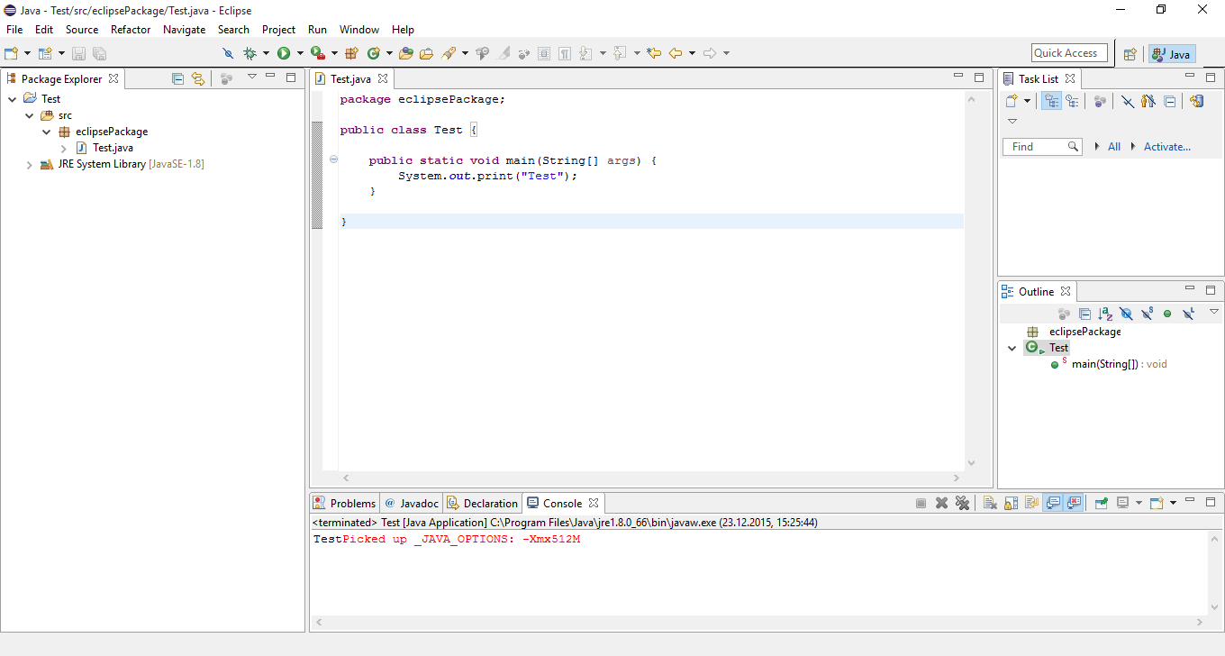

we have java programming in school so I want to programm with eclipse at home. First I installed Java and the JDK. Then I downloaded Eclipse. Then I write a short test. I write System.out.print("Test");
Normaly everything should be ok with this. But the Eclipse console says "TestPicked up _JAVA_OPTIONS: -Xmx512M"
I don't know why. I think it have something to do with the environment variables but I don't know.. Can someone help me?
greetings
Simon

Looking at your picture there are 2 clues. one the different color of the extra string. that indicates it came out on the error output.
other thing is that you used javaw (the version for gui running) try doing it with the console executable java and see if the message reappears.

In other words, Simon, check out:
https://wiki.eclipse.org/Eclipse.ini

(Sorry, I/Bill mean the third Windows option using java.exe.)
