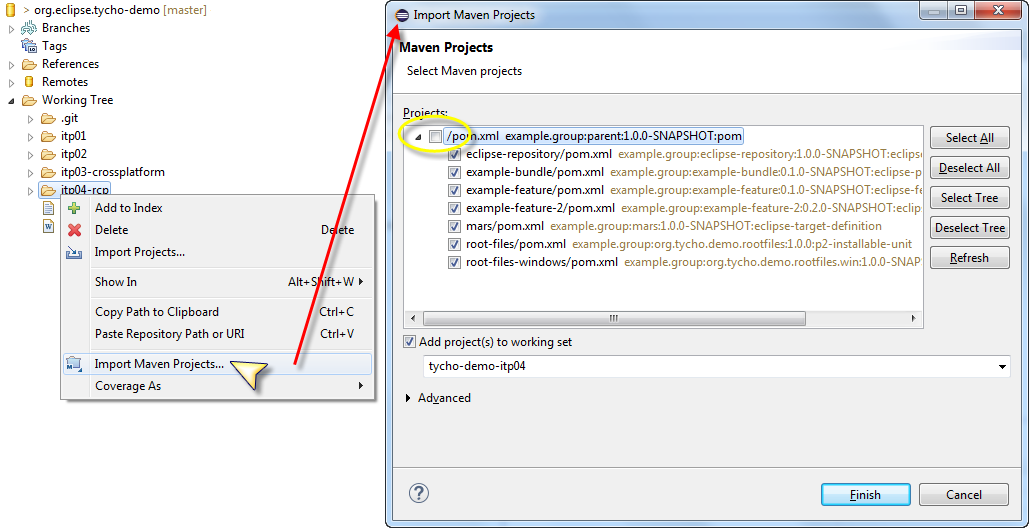

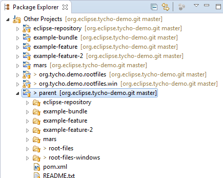

When I run the setup, all m2e projects are materialized (projects are called with the artifactId value):
index.php/fa/24358/0/
I do not need to get a project for the pom.xml at the root (artifactId:parent in the "itp04-rcp" example).
How can I tell the "Maven Import" task that it should not import the root pom?
I thought there was an exclude option.

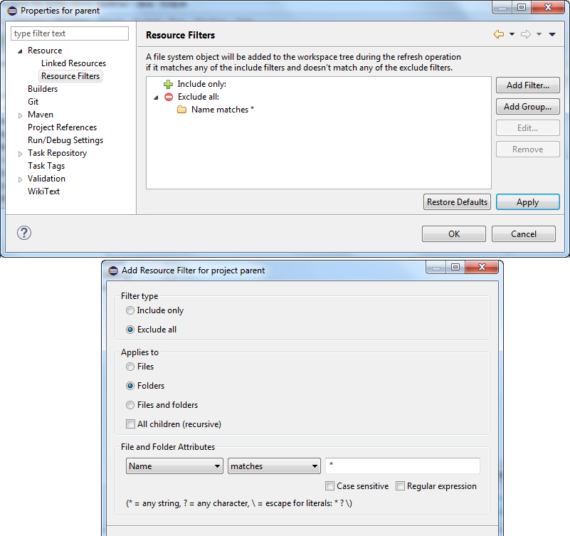

Resource filters is something that would do what I need.
index.php/fa/24408/0/
Here is the corresponding entry in the .project file:

To setup the project manually, I would select "Import Maven Projects..." and then I would deselect the root pom; but I am not sure that this is the recommended solution.

> Filtering resources in .project will not work (unless this is something we can fix after the project import with Oomph).
A Resource Modify task after the project is imported into the workspace...
