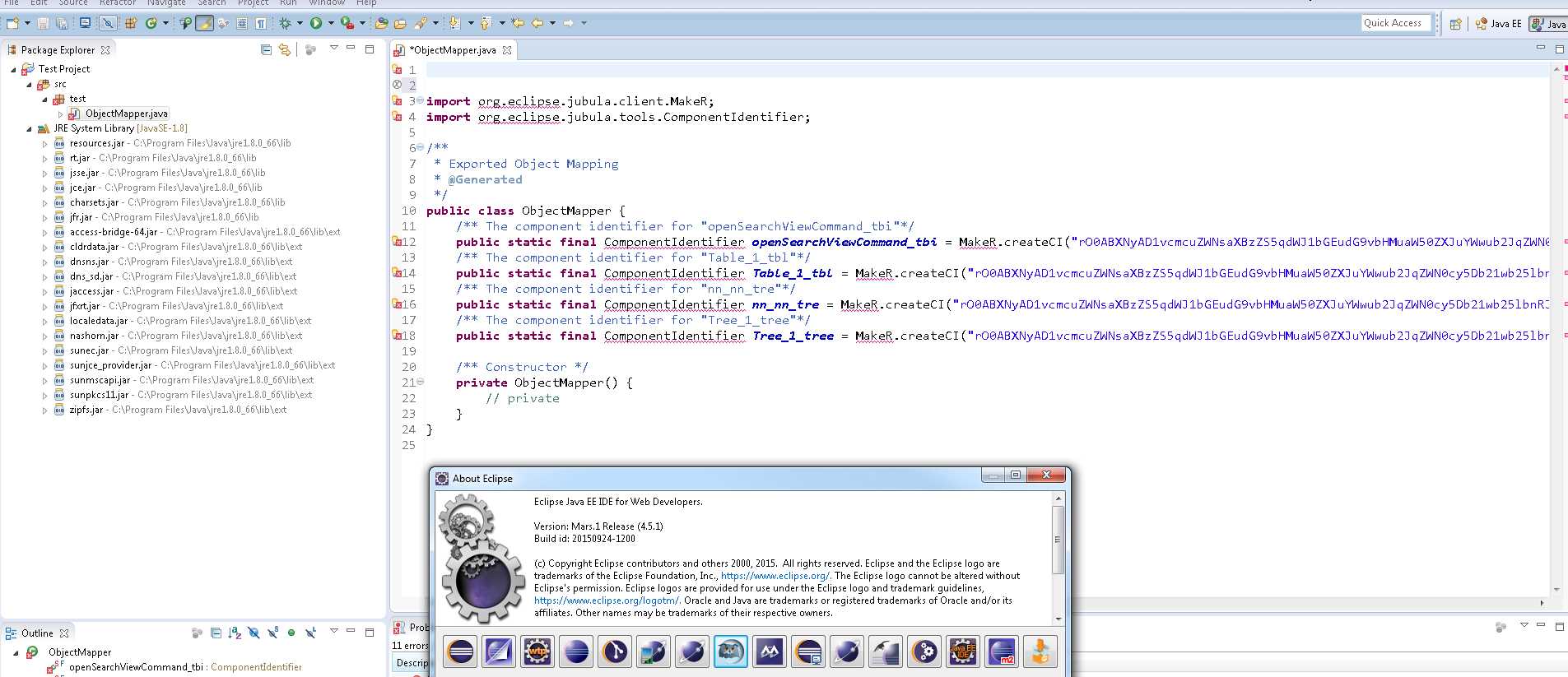

I am working with the Jubula ITE. Successfully Exported the Object Map in the ITE.
When i add the ObjectMapper.java to my project i can't find the dependencies to all of the toolkit neutral parts of the API:
org.eclipse.jubula.client.api
org.eclipse.jubula.client.api.commands
org.eclipse.jubula.toolkit.api
org.eclipse.jubula.tools
org.eclipse.jubula.communication
am I going the right direction? Using Mars JEE, Jubula is installed. Do I have to install other things?
(See image please)
Tnx in advance

Hi Michael,
Thanks for the details and the screenshot. It looks like you haven't declared the dependencies to the Jubula API Jars. We've got an FAQ entry to help you get started with the Client API here:
http://testing.bredex.de/faqs/jubula-api-setup.html
As it suggests, I'd check out our examples first, then adapt your project based on the further steps and the flavour you want to consume the dependencies in.
Hope that helps!
Alex
