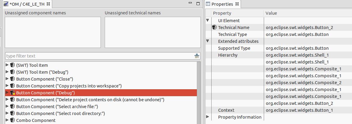

The following image shows Jubula's Object Mapper when capturing the "Debug" button on Linux:
index.php/fa/24308/0/

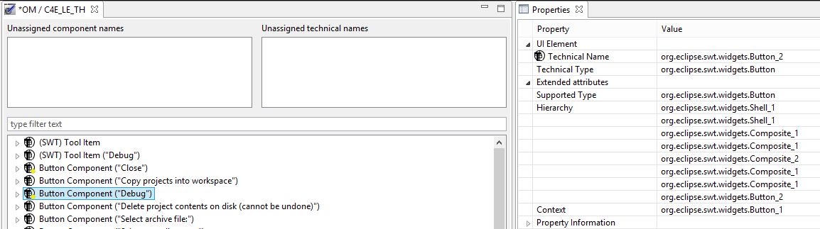

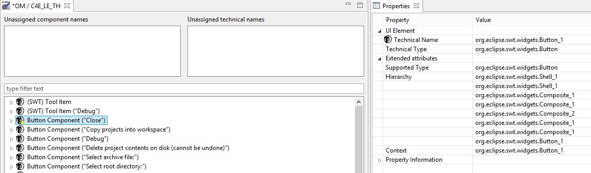

And when capturing the "Debug" and "Close" buttons, respectively, on Windows:
index.php/fa/24309/0/
index.php/fa/24307/0/
As you can see from the images, the buttons result "swapped" on Windows in respect to Linux. So when I run tests on Windows, Jubula clicks on the "wrong" button, in this case, Jubula will click on the "Close" button instead of "Debug" and vice-versa.
