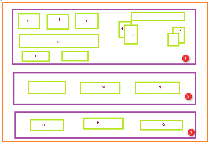

I am Beginner for Sirius. With the help of Sirius Diagram Description, I need to create container( 1, 2 , 3) and nodes under the container(A, B, C , D etc) as in the attached image.
With respect to the root, I need the container(1,2,3) elements to be aligned vertically ordered( same position as indicated) and the node elements(A B C ) under the container should be arranged in the same way as indicated in the picture.
I created a container for Layer (1,2, 3) and selected Horizontal stack for Children Presentation[/b] . Then I added a SubNode under the container for sub elements (A, B, C) under the the layer. Though they are the children , the nodes created are not getting displayed when Horizontal Stack for Children Presentation is selected.
If we select Free Form for Children Presentation, the nodes are getting displayed.
Could some one suggest me
1. how could i arrange the elements under the layers as depicted in the picture
2. Also how to arrange layers in order such that layers are should not be arranged in random order.
To do this you should create a root ContainerMapping with children
presentation set to VerticalStack and then one or several sub
ContainerMapping (dynamic or fixed) with children presentation set to
FreeForm
See the beginning of this message and do not hesitate to validate the
VSM (the odesign file: Viewpoint Specification Model), the validate menu
on any VSM element will trigger the validation of the sub tree.
In your case, the validation should throw errors indicating that there
should not be any NodeMapping in a H/V stack container.
I answered a few line ahead for the 1/2/3 containers.
For the horizontal layout of sub nodes, I think this should be the
default arrange all behavior for non pinned elements. If you want to
force this layout, I think you might have to provide your own layout
extension through the GMF extension point (arrange all) or you might try
other means (like precommit listener) to always for the positions.
The order of the 1/2/3 compartments will be computed from the mapping
order and then the semantic candidates order.
> Thank you.
Maxime - Obeo
[1]
https://www.eclipse.org/sirius/doc/specifier/diagrams/Diagrams.html#containers
