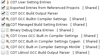

Re: Helping the indexer [message #1717042 is a reply to message #1717028] Wed, 09 December 2015 12:43 Go to previous messageGo to next message
Tnx, but:
index.php/fa/24254/0/
It looks like the correct ones are checked:
- CDT User Setting Entries
- Exported Entries from Referenced Projects [ Shared ]
- CDT GCC Build Output Parser
- CDT GCC Buildin Compiler Settings [ Shared ]
- CDT Managed Build Setting Entries [ Shared ]

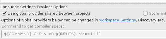

Re: Helping the indexer [message #1717061 is a reply to message #1717042] Wed, 09 December 2015 13:15 Go to previous messageGo to next message
But you aren't getting any compiler settings.
The command displayed in the bottom pane of the Providers dialog is ..... ???
index.php/fa/24260/0/
What happens if you execute it in a command window?
Note: to get it to work outside of Eclipse you have to be compiling an empty source file.
no.cpp is an empty file.
You should get something similar.

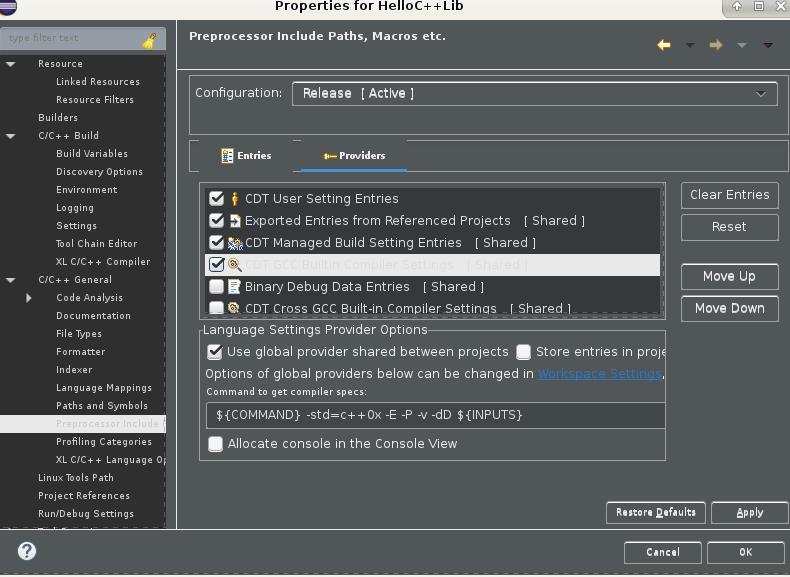

Re: Helping the indexer [message #1717069 is a reply to message #1717061] Wed, 09 December 2015 14:15 Go to previous messageGo to next message
I am getting about the same output.
g++ --version provides
g++ (Debian 5.3.1-3) 5.3.1 20151207
index.php/fa/24263/0/
As far as I can remember I have compiled everything again after debian unstable switched to new C++ Api.
Will need to look into that again tomorrow ...

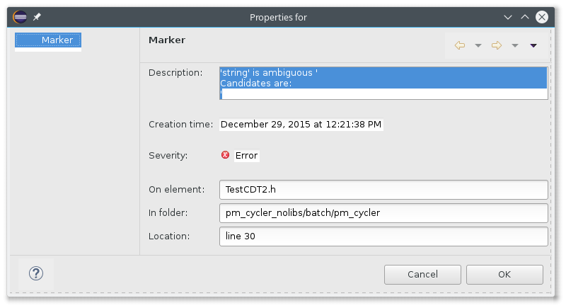

Re: Helping the indexer [message #1718716 is a reply to message #1718109] Tue, 29 December 2015 07:16 Go to previous messageGo to next message
This is what I get, when I right-click in the problems view on the first error:
index.php/fa/24439/0/
So, it doesn't say what is bothering CDT, what string types cause the confusion.
Log4cxx is a logging library for C++, the code of the library is not soo simple.
I think, there might be other people using both tools.
Again, in the past this didn't raise any errors.
It seems, I have exhausted all ways at looking inside eclipse for causes of the error.
