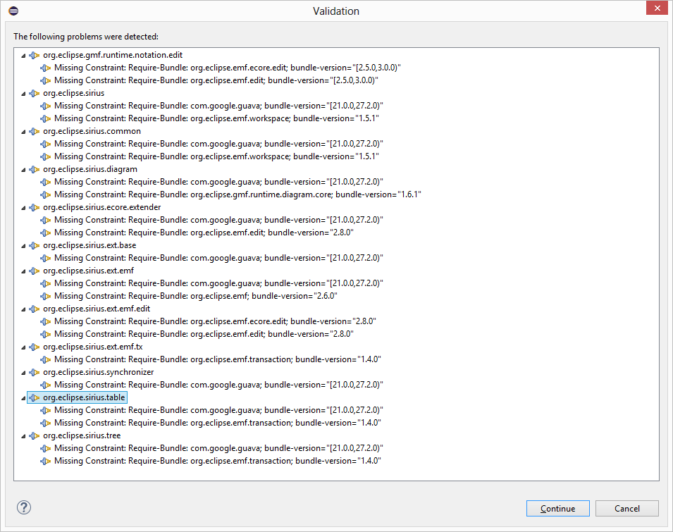

I have tried doing the same and I keep getting error messages when testing my product about "missing constraint: Required-Bundle: ..."
I am attaching an image with the missing packages when trying to produce a Sirius-based product. Any tips?
Anyone has a good resource on producing Sirius based product configuration?
