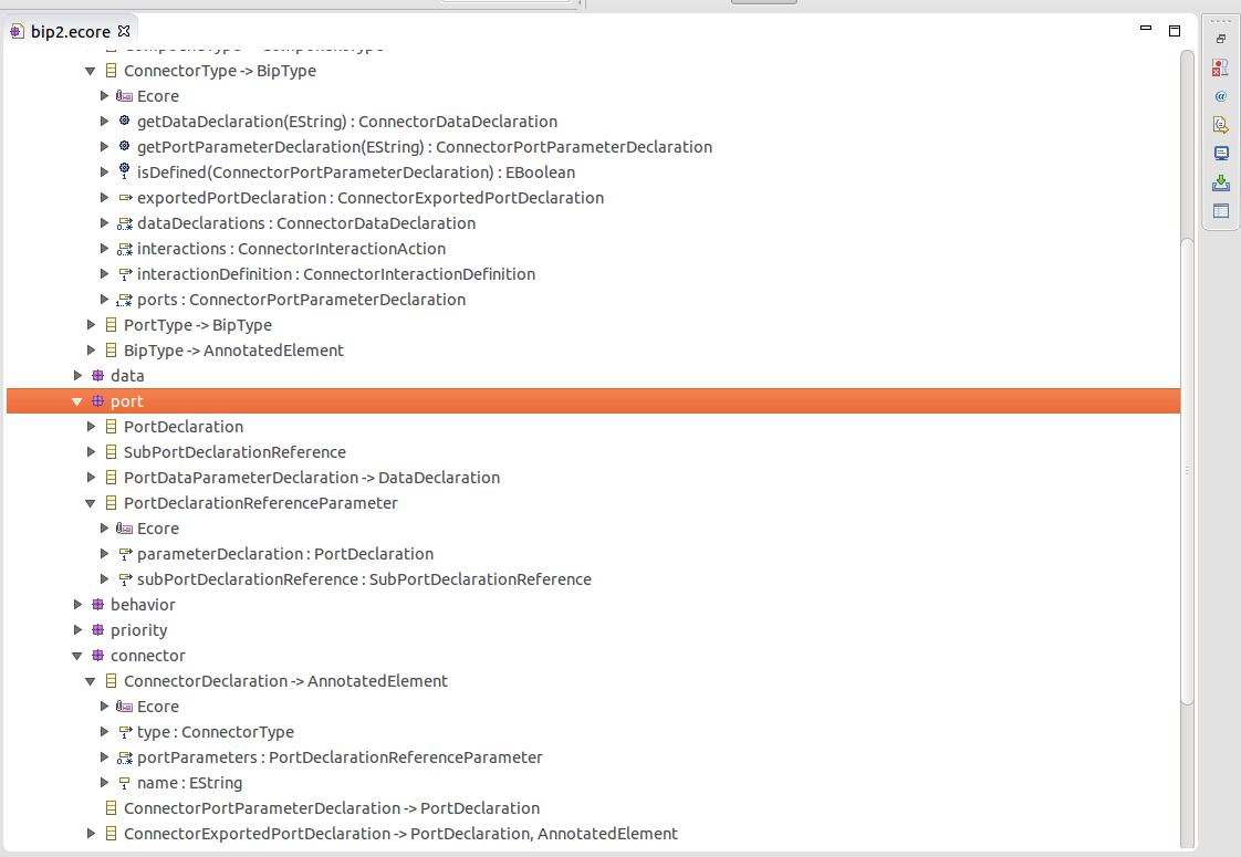

I have a problem when I want to create a Node in the way I will describe below.
In my meta-model I have a class named ConnectorDeclaration which contains a list of objects of the class PortDeclarationReferenceParameter (named portParameters), and an object of class ConnectorType (named type). In the ConnectorType class there is a list of objects of the class ConnectorPortParameterDeclaration (named ports). See next picture for all of this.
index.php/fa/24127/0/
When I want to create a Node which will represents and instance of the class ConnectorDeclaration, in the same time I want to fill the list portParameters and this objects to show as a Border Nodes. The size of this list is the same with the size of the list ports in the ConnectorType class.

thank you for the answer. But, in fact there is another problem. In the time when I will create an instance of the ConnectorDeclaration the type is not set. So after creating an instance, in the Properties window I set the type of the ConnectorDeclaration. I implemented your solution, but because of this issue the Border Nodes are not appearing. I tried to put a fix number in the Expression in the for loop (let's say 1), and it worked. So, I think the problem is how to do the same, but after seting the type in the Properties window.
