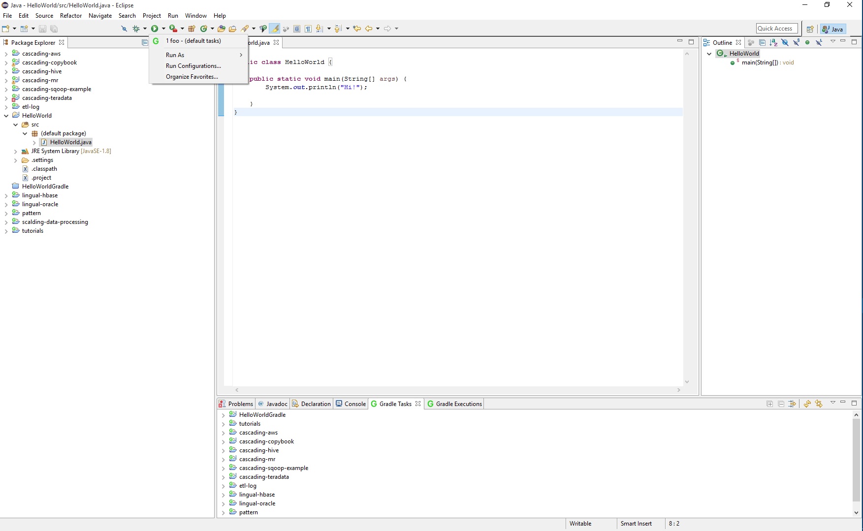

Bob, I don't understand what you mean by "Gradle took over my Eclipse." Can you give more details, maybe even some screen shots. I have 2 different Eclipse installations with Buildship, but I'm not seeing anything unexpected from them.

What I mean by taking over is that Eclipse was basically forcing me to make everything a Gradle project. In the screen shot you can see that I have my HelloWorld class. All I want to do is to be able to run that class. When I go to hit the Run button, as you can see in the screen shot, running my class isn't even an option.
I actually solved this while I was writing this post. I went to the menu options Run -> Run and it ran and then THAT action actually added back the ability to run the class to my Run button. Weird.

I think what you were running into is a configurable behavior about the Run toolbar button. Basically, its default behavior is to run whatever the last application you ran, not what you are currently looking at. It can be configured in Preferences to launch whatever editor has focus, which sounds like what you were expecting to happen.
See this for more details.
