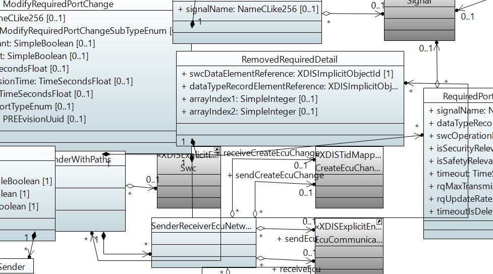

I have existing project, where I have lots of class diagram, previously I have been using windows 7 on desktop, but now I have laptop and windows 10 installed on it. when I open class diagram it is messed up.(see Attachment)
I am using eclipse Mars.2 Release (4.5.2) and papyrus backbone 1.1.4. I have tried to change my laptops resolution and many other things. but nothing seems to work. refactoring all diagrams seems to be time consuming task, and other colleagues are still using windows 7. is their any solution to this problem?

Is your new laptop using High DPI setting? If so, I believe this would make fonts bigger, which in turns makes elements (classes) bigger as well (Unless they have been manually resized, in which case they should keep their original size in pixels).
Papyrus doesn't properly support High DPI (So in some cases, layout could indeed be very different on a high DPI display). Unfortunately, there's not much you can do about this at the moment

Many thanks for the info - in later versions of Windows setting the DPI scaling to 100% seems to make things usable again. Is the issue with Papyrus, GMF or Eclipse and do you know if a fix is planned?

It's probably a problem somewhere between Papyrus and GMF. I believe GMF supports scalable units, based on the DPI level, but Papyrus always uses pixels (So texts are scaled, but figures aren't, causing layout inconsistencies)
In Papyrus, we provided a workaround to optionally use a fixed label height (In Pixels), to improve diagram layout stability: https://bugs.eclipse.org/bugs/show_bug.cgi?id=535519
You could apply this workaround with a CSS Stylesheet containing this rule:
    labelHeight: 16 /* Pixels */;
labelWidth is also supported, but text length varies more than text height; so it's not really usable in practice (If the value is too high, scrollbars may appear; if it's too low the text will be truncated)
With this rule, the text will be truncated when necessary, instead of expanding the figure, which should result in more stable layouts across platforms/screens.
