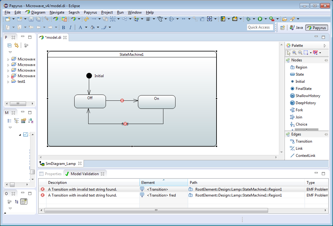

I have created a very simple state machine diagram. I am seeing an error indicator on the transition itself and message "A Transition with invalid text string found. <Transition> fred RootElement::Design::Lamp::StateMachine1::Region1 EMF Problem" in the Model Validation window.
I am not sure if this is a bug - or if I have done something wrong.
Does anybody have a tutorial on using State Machines in Papyrus - just incase I am getting this wrong.
Thank you..
Re: Error indicator on transition in State Machine - Using SysML on Mars [message #1715758 is a reply to message #1715640] Wed, 25 November 2015 13:21 Go to previous messageGo to next message
I believe that I have a work-around for this....
A clue in another posting suggested that sometimes entering names on an edge does not result in the name being added correctly. This can result in a blank name - and hence the error. However, this can be corrected by simply adding the name for the transition in the Properties tab. This, in itself, does not clear the error report (hence a name and an error marker on the attachment in my previous post). The trick then is simply to clear the error indicator using the model validation tool. The error is no longer indicated and does not re-appear.
