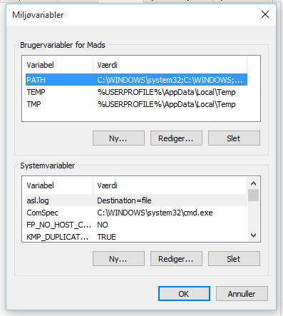

I think that I might have made a mistake in "Setting up the software enviroment" pdf page 2. I deleted the PATH by accident under "System variables". I've tried a numerous of different combinations to include the right things in the PATH. See image below:

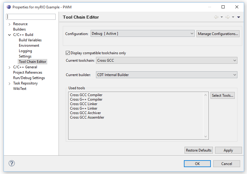

When I follow the user guide, I don't get any error codes. See image below:

So what happens when you try to build? What's in the build log?
You are running under Windows and trying to build and run a program for Windows but the tools chosen (GCC suite) are built to run under Linux. In fact, the title of the section on page 5 is "Using C support for myRIO with Eclipse for NI Linux Real-Time". The files in the zip for /C Support for myRIO/ contains a Linux dynamic (.so) library.
Cygwin provides a *nix environment under Windows. You could try running everything in a Cygwin console. GCC also has to have been installed into Cygwin. Optionally,. you could just point Eclipse to the Cygwin executables and libraries either explicitly or bia the PATH environment variable.

I added one of the projects and discovered that the compiler used is arm-nilrt-linux-gnueabi-gcc.
At least that's what Discovery tried to use.
This apparently is a cross compiler built by or for NI.
The Eclipse being used is not the standard Eclipse but some version modified by or for NI.
Presumably the install package also includes the compiler.
Since you have a 64 bit version of Windows, you need to add the following to your path environment variable (according to the pdf file):
(Windows 64-bit): C:\Program Files (x86)\National
Instruments\Eclipse\14.0\arm\sysroots\i686-nilrtsdkmingw32\usr\bin\armv7a-vfp-neon-nilrt-linux-gnueabi
And presumably it is a Windows executable so Cygwin and MinGW would not be needed.
In general, there should be something in a Build Console view that would show what is happening during the build but, as this is a modified version, who can say?
