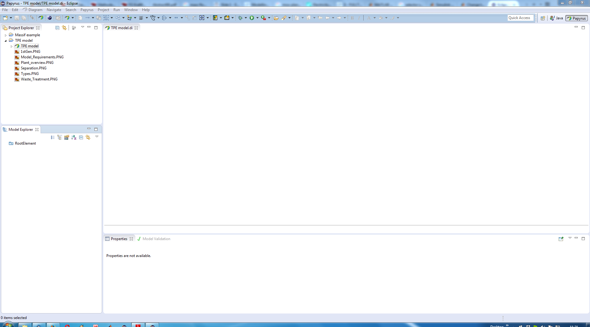

Hello everyone,
I got kind of a problem here... I created a SysML-model using Eclipse Mars. I worked on that over quite some time, saving, exiting and loading as normal. But now, when I try to open that model, the Model Explorer claims the model is empty. All the files (.di, .project, .uml, ...) seem to be in place. The last thing I did with that model was exporting diagrams as .png I think (which I did before as well, and which shouldn't matter anyways).
I also tried opening it on Eclipse Luna (which I still have installed, without using it), but as to the same effect (only that the model explorer will show me the imported ModelLibraries (Ecore Primitive Types, UML Primitive Types), but I don't think those are model specific).
Anyone got any idea what to do? I am running a Windows 7 machine, could follow up with hardware specs if that would help any...
Thanks a lot!
Adrian.

Re: Error: Model content will not be shown [message #1715402 is a reply to message #1715393] Mon, 23 November 2015 05:37 Go to previous messageGo to next message
Here, in reply to both:
I checked the .uml, it does seem as if there was no model information in there, but only information about the applied profiles:

I compared to another model I have, which looks very differnt. So, I am loosing hope here? Did not backup my files, as of course I should have done.... Argh! Any idea on what could have happened?
Attached is a screenshot of what it looks like. There is no error log, as Papyrus opens the model without complaing; only problem is, that it seems to be empty.
So, rebuild and backup more frequently? At least I have the exported .png's to guide me, so I will just take the whole issue as a warning...

Re: Error: Model content will not be shown [message #1715416 is a reply to message #1715402] Mon, 23 November 2015 07:44 Go to previous messageGo to next message
Indeed, this is an empty model. It would be interesting to know how you got there.
Anyway, you can try the Eclipse's Local History to get a backup of your model. Right click on your *.uml file > Replace with... > Local history
You may have to do the same thing with the *.notation file
Eclipse cleans the Local History from time to time, so no guarantee that it's going to work
