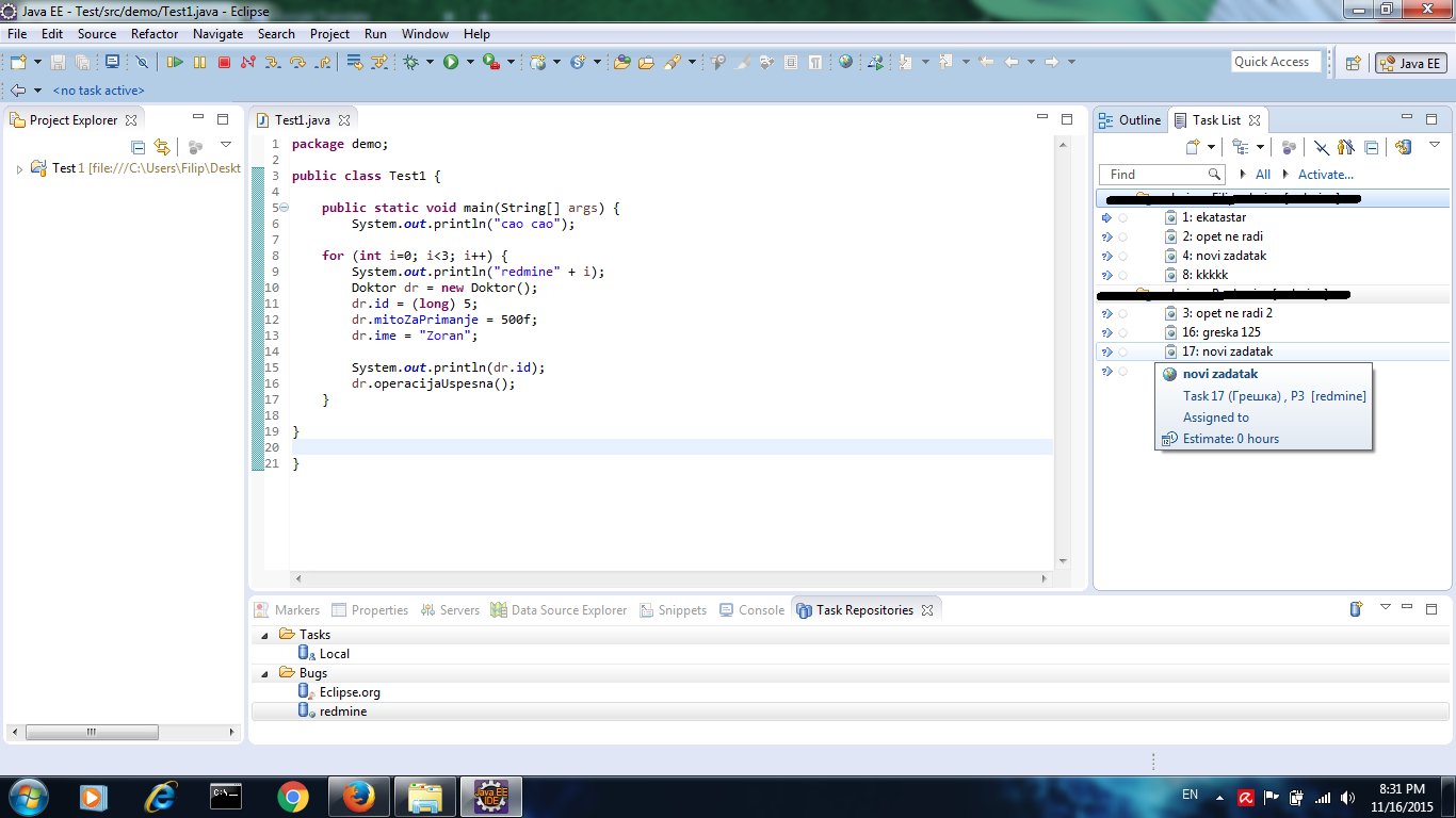

Hello Sam, thanks for update.
I could open the task list, but i havent seen the tasks. This issue is now solved, the problem was with filtering the assigments to specific users ID. But I still cant install the taks list index, see attachment.
Also when I hover over a specific task the assigned to field is blank (It would be nice that all the details that are visible in redmine be visible here in the tasks list), whats with that? Tasks are assigned to specific user in redmine.

Re: mylyn task list [message #1714811 is a reply to message #1714802] Mon, 16 November 2015 17:09 Go to previous message
The installation error is because it can't find org.eclipse.mylyn.commons.net, which is on the commons repository. I recommend installing from the snapshot or release repository instead so that all required plugins will be found.
The problem with the blank assignee in the tooltip sounds like a bug in the Redmine connector, so you might want to report it to them.
