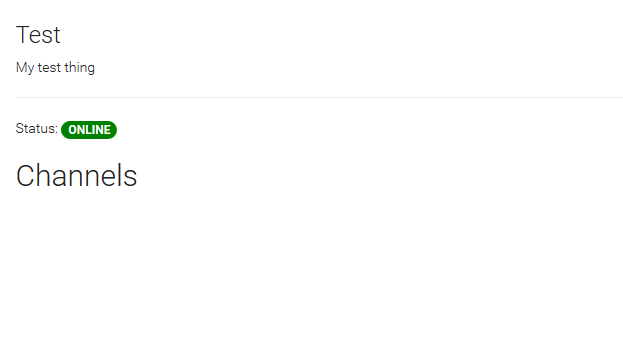

Hello all,
I'm trying to implement a binding which dynamically creates channels as described here: https://www.eclipse.org/smarthome/documentation/development/bindings/thing-handler.html
During runtime the Thing is created just fine, I do not get any error but the Item is not showing any channel in the UI.
What am I doing wrong?!
I've attached the source of my TestHandler and two screenshots showing what I mean...
Thank you and regards,
Osman

I just tryed the newly introduced method - unfortunately the channel is still not showing
If you mean it is not shown in the Paper UI, then this is unfortunately expected behavior. As written above (see https://www.eclipse.org/forums/index.php?t=msg&th=1072114&goto=1714589&#msg_1714589), the Paper UI still needs to be adapted for this newly introduced feature. I´m currently working on that.
Re: Dynamically created channels are not shown [message #1715165 is a reply to message #1715143] Thu, 19 November 2015 12:38 Go to previous messageGo to next message
Oh... then I think, we've been talking "leicht aneinander Vorbei" Very Happy
I thought the Paper UI is not showing the channels only because they do not have a channel type... But OK. I'll be waiting for the new Paper UI version.
Again, thank you much.

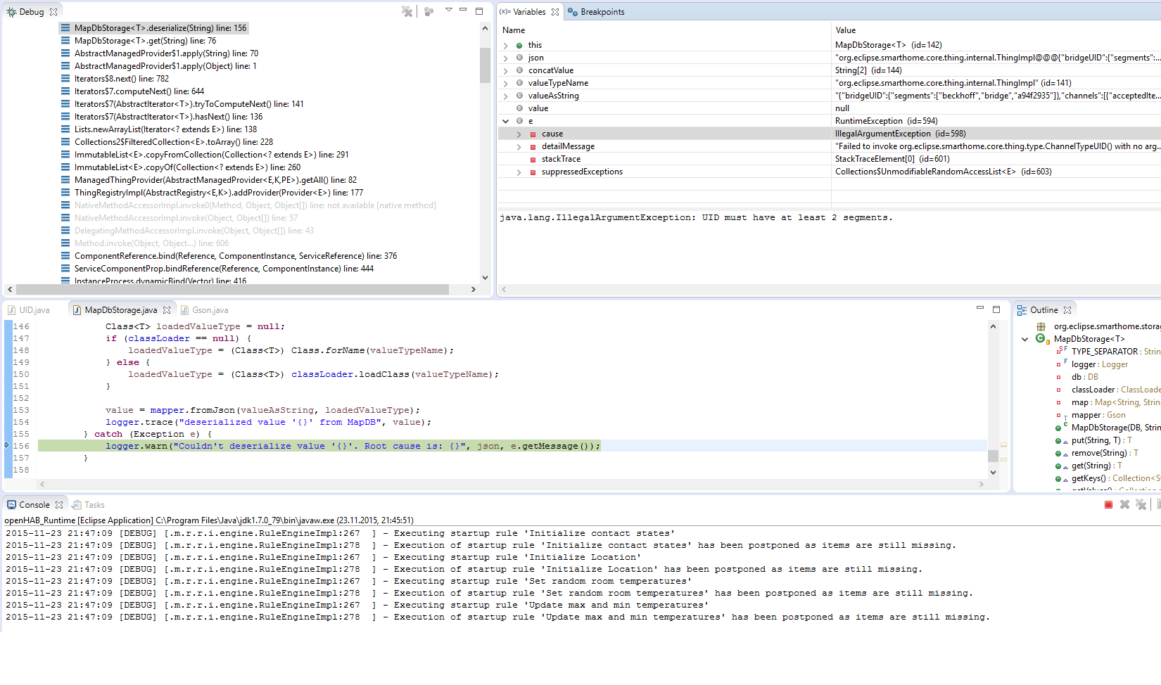

Re: Dynamically created channels are not shown [message #1715464 is a reply to message #1715386] Mon, 23 November 2015 15:55 Go to previous messageGo to next message
Thank you for the PR.
I just pulled from master and rebuilt the solution - the bug seems to be still there... or the successor of that bug Sad
Exception: java.lang.RuntimeException: Failed to invoke org.eclipse.smarthome.core.thing.type.ChannelTypeUID() with no args
Root cause: java.lang.IllegalArgumentException: UID must have at least 2 segments.
index.php/fa/24053/0/
The line from the Log file:
2015-11-23 21:54:58 [WARN ] [e.s.storage.mapdb.MapDbStorage:156  ] - Couldn't deserialize value 'org.eclipse.smarthome.core.thing.internal.ThingImpl@@@{"bridgeUID":{"segments":["beckhoff","bridge","a94f2935"]},"channels":[{"acceptedItemType":"Rollershutter","uid":{"segments":["beckhoff","rollershutter","a94f2935","MAIN_fbEg_fbShutter1","channel"]},"channelTypeUID":{"segments":["beckhoff","rollershutter"]},"configuration":{"properties":{}},"properties":{},"defaultTags":[]}],"configuration":{"properties":{"symbolName":"MAIN.fbEg.fbShutter1","forcePolling":false,"pollingPeriod":10}},"properties":{},"uid":{"segments":["beckhoff","rollershutter","a94f2935","MAIN_fbEg_fbShutter1"]},"thingTypeUID":{"segments":["beckhoff","rollershutter"]}}'. Root cause is: Failed to invoke org.eclipse.smarthome.core.thing.type.ChannelTypeUID() with no args
  • Attachment: s.png
    (Size: 118.09KB, Downloaded 1505 times)
