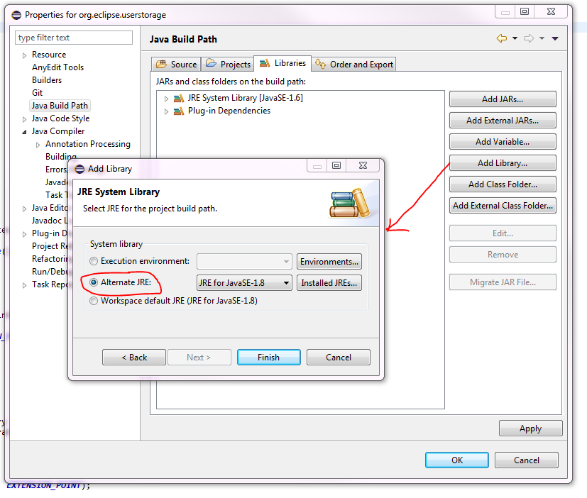

I think if a project needs a specific JRE then that should be configured in the project's Properties dialog (right-click
on the project). I've attached a screenshot...
