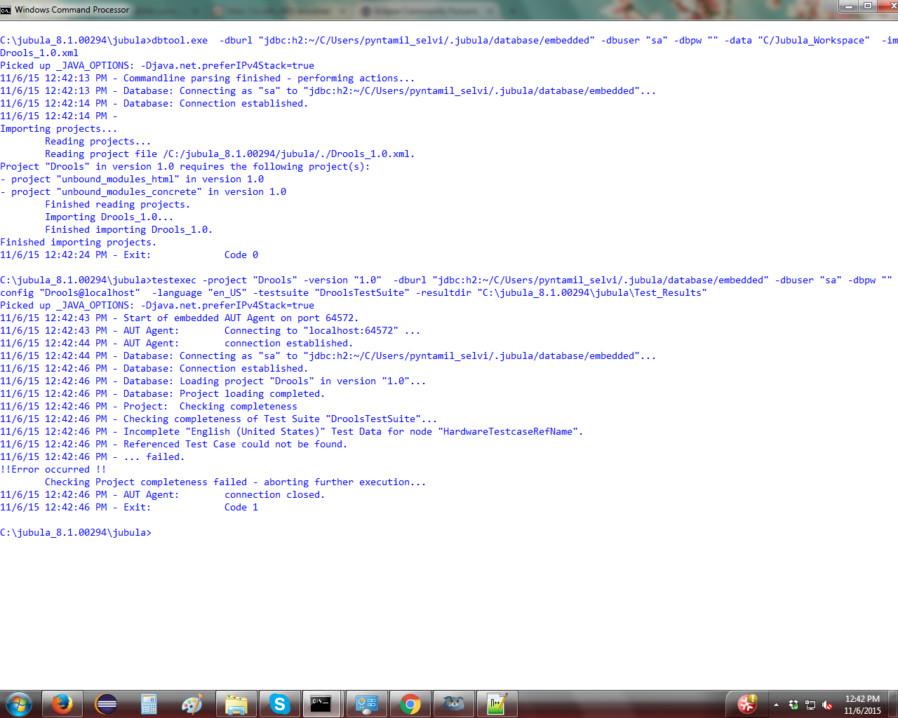

I have imported the project through DBtool but when I open Jubula ITE imported project not found.I am using Jubula version 8.1 in WIndows 7.PFA of imported project through dbtool successfull but running project using Testexec shows error.
Thanks in advance,
Pyntamil

Re: Imported through Dbtool but when I open it in Jubula ITE ,imported project is not found [message #1713714 is a reply to message #1713707] Fri, 06 November 2015 02:37 Go to previous messageGo to next message
The testexec command line shows that there is missing test data for a node, because a referenced test case cannot be found. The project is in the database and can be found, but something is missing. My first guess would be the unbound modules concrete or html - can you open the ITE and select "project -> open" and then check whether the unbound modules concrete and html in version 8.1 are available in the database? If they aren't you can import them.
Alex

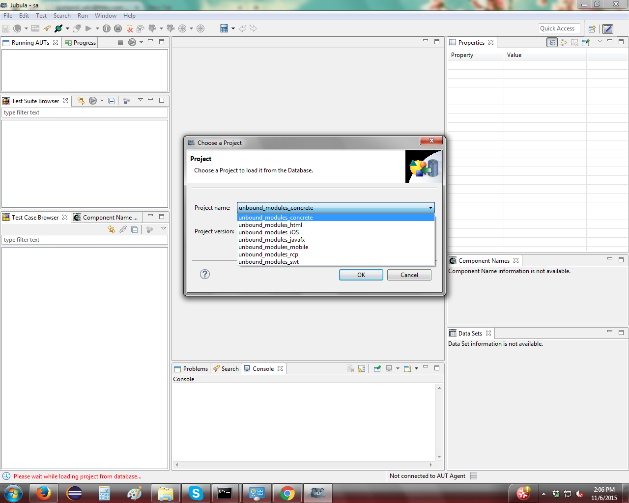

Re: Imported through Dbtool but when I open it in Jubula ITE ,imported project is not found [message #1713725 is a reply to message #1713714] Fri, 06 November 2015 03:42 Go to previous messageGo to next message
Hi ,
PFA of Jubula ITE.It has unbound modules concrete and html in version 8.1 and are available in the database.
Pyntamil
  • Attachment: Jubula.png
    (Size: 157.29KB, Downloaded 147 times)
