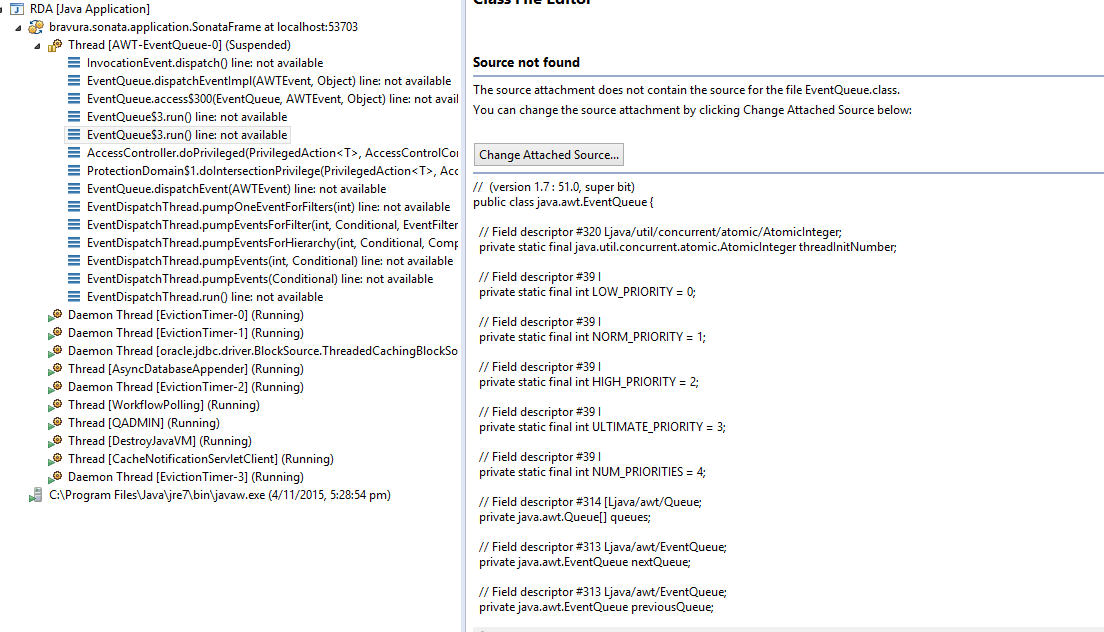

I'm fairly new to Eclipse and keep encountering an issue when stepping through code. Many files say - 'not available'. Screenshot attached.
I'm using JDK1.7 and my classpaths are set up to point to rt.jar amongst others.
How can I get these source files to show up so that I can continue stepping through my code? The bug I'm trying to solve appears at the point that it goes into these files.

Click on the "Change Attached Source..." button. You'll get a dialog that allows you to point to the source.
