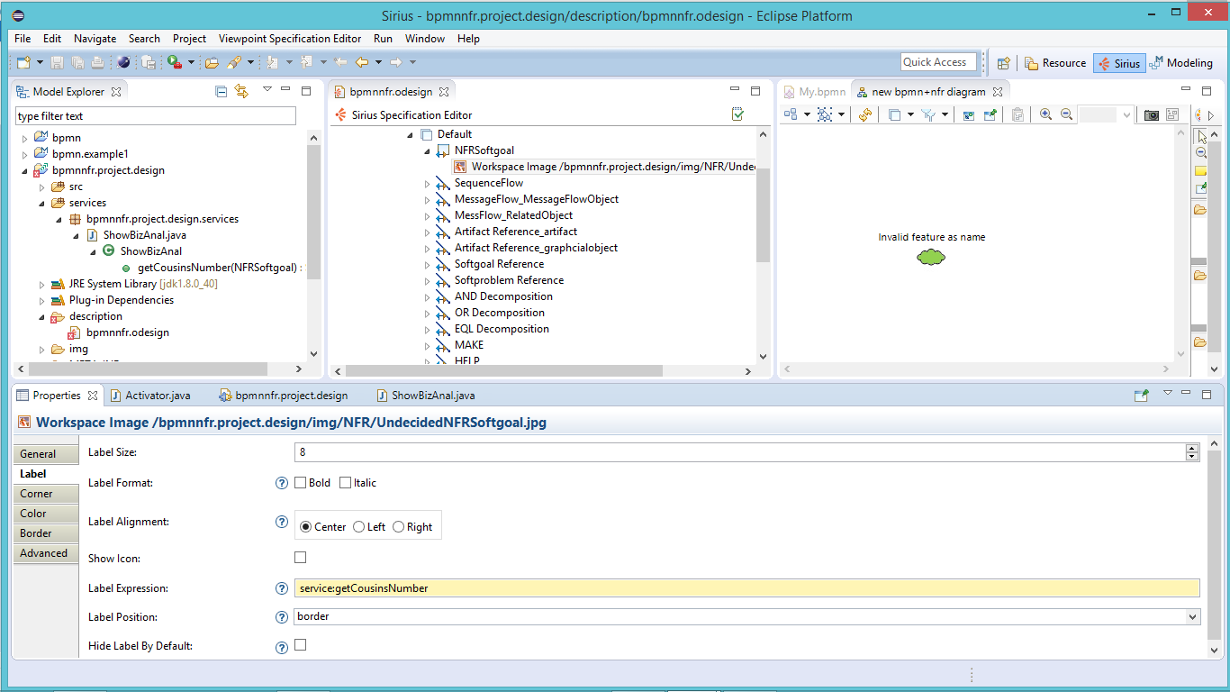

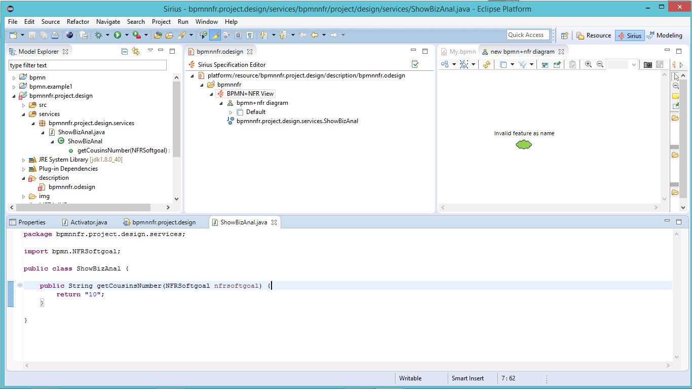

I had another problem while using the Java Service.
I followed the advanced tutorial [1], but my program doesn't work.
I attach my screen shots.
Could someone help me to find something wrong?
Thank you in advance.

Do you have validation errors on your odesign? Have you exception in
error log when using the diagram editor? It seems that your label
expression is not correctly evaluated, perhaps because your java service
is not found. You could try by changing the type of the parameter in
your java service, try with EObject instead of NFRSoftgoal and set a
breakpoint in debug in your java service to see the real type of argument.
Best Regards.

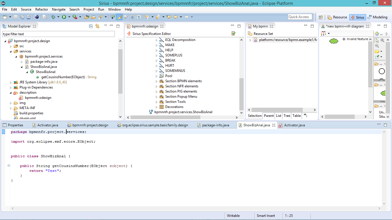

Hi Esteban,
Thank you for your comments.
I changed the parameter , but it still the odesign file cannot recognize the Java Service that I defined. It showed error message before I executed it. Could you take a look at it once more?
I don't know why this happen. I tried to several ways, but it doesn't work.
Thank you so much.
