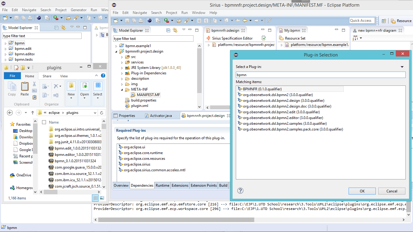

I'm trying to use Java Service. I read an article that for the Java Service, odesign project has the plug-in which contains its ecore file.
To do it, I made the plug-in for my bpmn ecore file.
By the way, when I click an add button for the dependency plug-in, there is no plug-in which I added in the ~/eclipse/plugin/.
The following is the picture.
index.php/fa/23823/0/
Does any body know why this happen?
I tried to execute -clean when execute the eclipse.
Thanks in advance.
Best Regards,
Eunjung Grace

Re: Plug-in Dependency Problem for Java Service [message #1713454 is a reply to message #1713407] Wed, 04 November 2015 04:23 Go to previous messageGo to next message
I could solve the problem. I just imported the ecore file in runtime environment. ^^

Re: Plug-in Dependency Problem for Java Service [message #1713458 is a reply to message #1713407] Wed, 04 November 2015 04:26 Go to previous messageGo to next message
This seems a deployement issue, to have your metamodel plugin deployed
you can :
- in development mode, launch a second runtime from your workspace
containing your metamodel plugin.
- in production mode, have your metamodel plugin deployed through a
feature or exported directly in the dropins folder of your Eclipse target.
Note your question is not Sirius related but only a deployment issue.
Best Regards.
