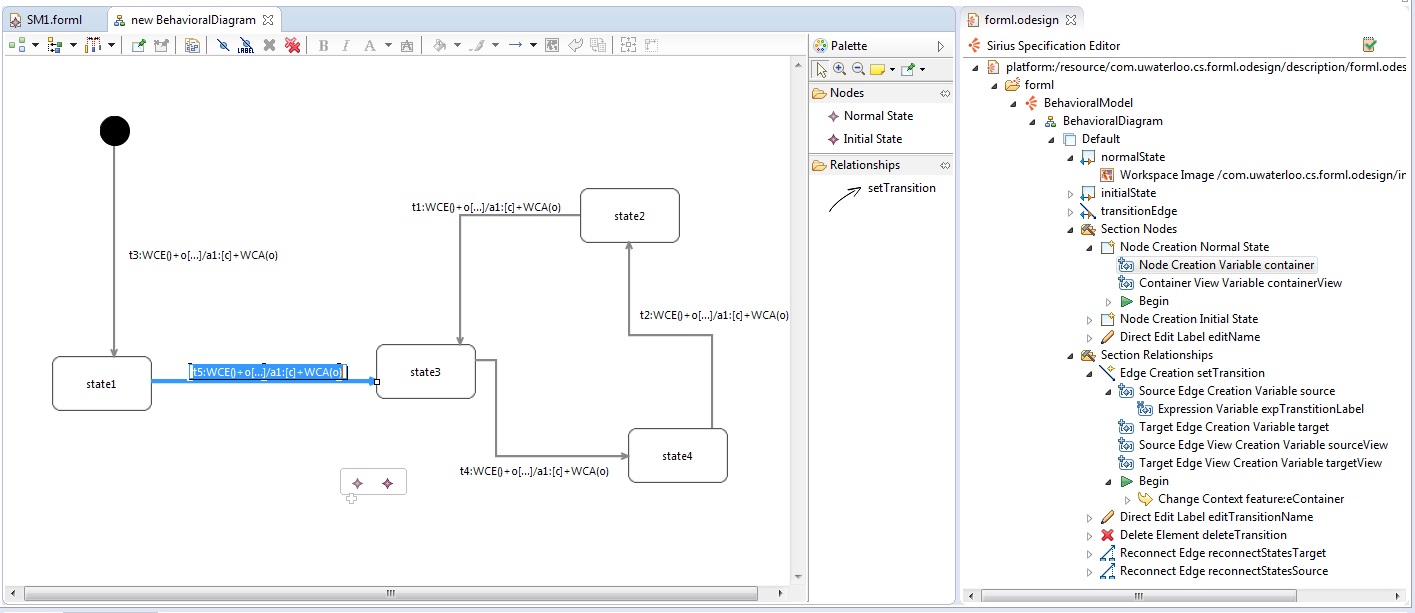

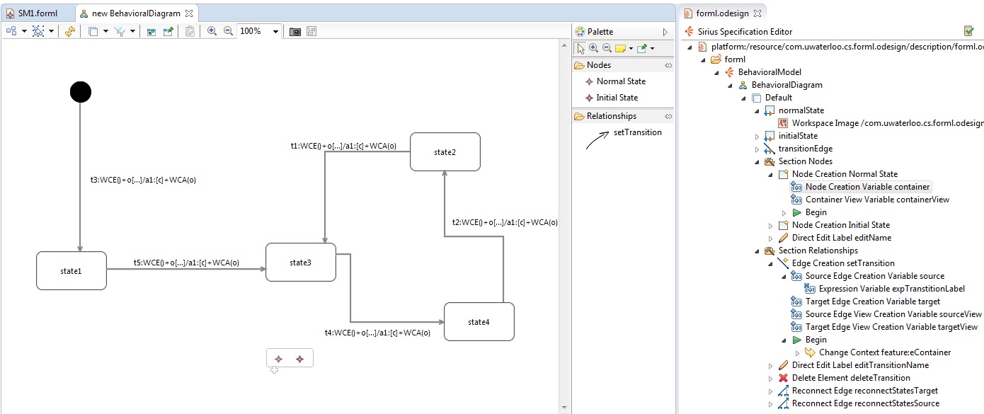

I don't think what you suggested is what is suitable for me. Consider the two attached images.
1:
2:
Image 1, shows what Sirius currently does when I create a new transition, for example t5. I have managed to preset the transition label and it automatically places a transition with the name pattern I suggested.
Image 2, is what I need immediately after placing a transition (e.g. for t5), which is bring the transition label to edit mode, and then select all the text. This is the default behavior of GMF.
What I think is that I can write a java service to be run immediately and invoke edit command of the transition (or something like that)!
Or, I write a java service which shows a jForm/jDialogue to the user and the user can set the label in a text box.
Or, I can manage to show a JDialog box in the semantic code (EMF part) that when a label is being created, the dialog box appear ?!
Which one do you advise ?
