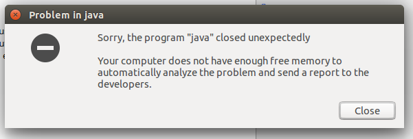

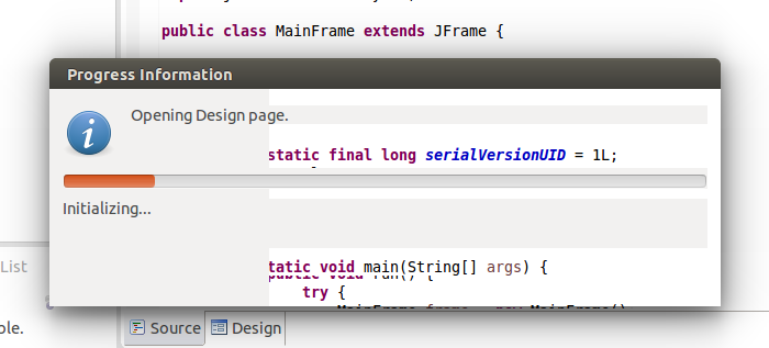

I have a fresh install of Eclipse IDE for Java Developers that includes WindowBuilder and a few other packages.
I am trying to learn how to use WB and when I open a file with WindowBuilder Editor, the source tab looks fine, but if I click the DESIGN tab a progress window opens and then waits a short time and eclipse crashes.
I have tried simple files freshly created by eclipse as well as existing code.
The last time I got these messages, but they are not constant, so may just be noise
[xcb] Unknown request in queue while dequeuing
[xcb] Most likely this is a multi-threaded client and XInitThreads has not been called
[xcb] Aborting, sorry about that.
java: ../../src/xcb_io.c:179: dequeue_pending_request: Assertion `!xcb_xlib_unknown_req_in_deq' failed.

I also added a couple of screenshots as well
Any suggestions to get more specific details on why this is crashing?
This is really weird since this is a standard install!
Tom
