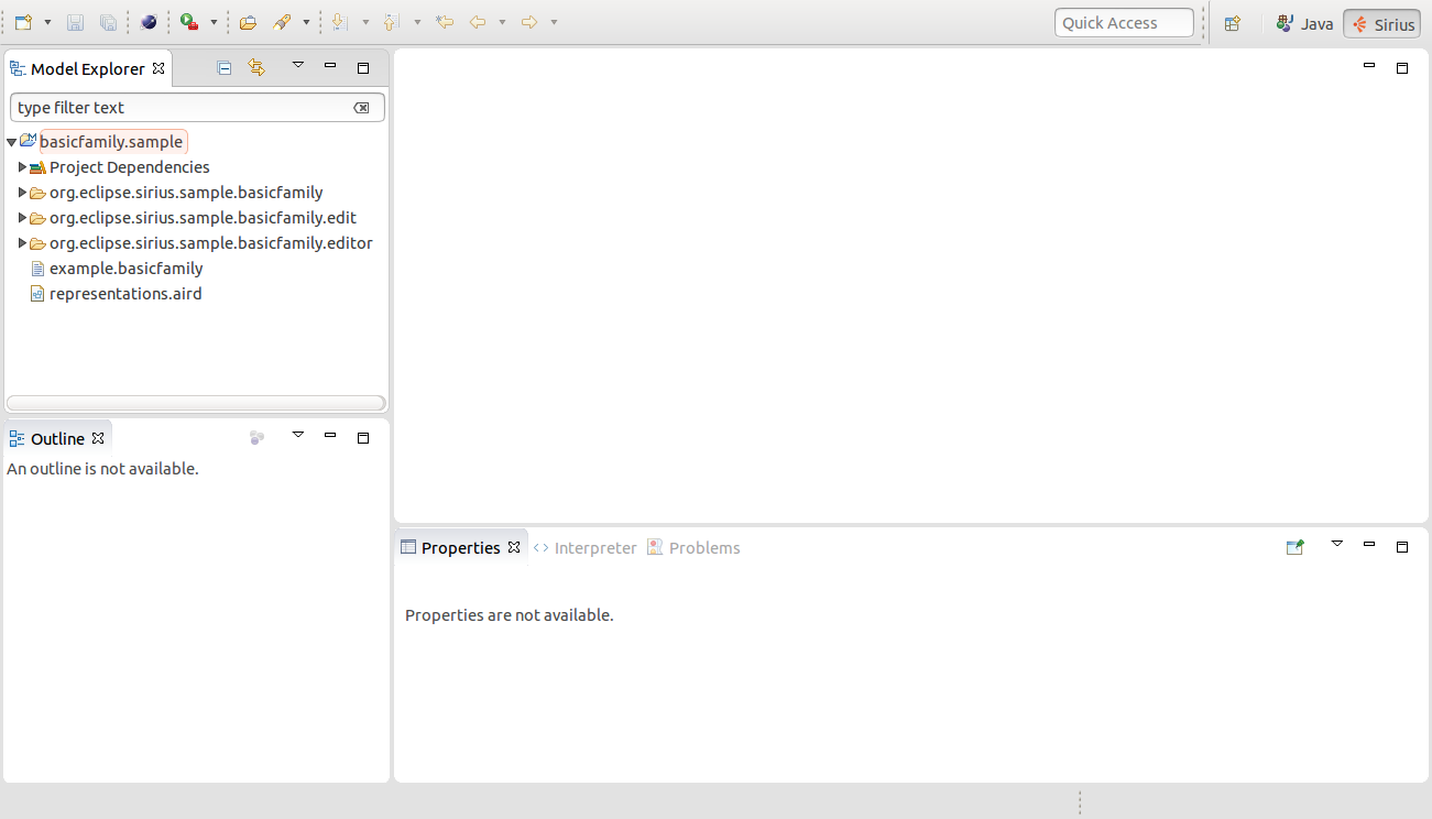

Voici la capture d'écran index.php/fa/23767/0/ montrant que le fichier xml reste un fichier texte dans l'aborescence du projet

The problem is here. You need to import projects contained in the zip
file as projects. The workspace should contains 3 projects after import
step (org.eclipse.sirius.sample.basicfamily,
org.eclipse.sirius.sample.basicfamily.edit,
org.eclipse.sirius.sample.basicfamily.editor). So before the step
"Launch a new runtime from your Eclipse", you need to have these 3
projects in your workspace.
I could also import the xml file but id didn't create the list of all
persons in the family but it remained as a XML file as if the eclipse
did not interpret the file.

Re: Installing basicfamily.sample [message #1713071 is a reply to message #1712943] Fri, 30 October 2015 11:07 Go to previous message
Thanks for your help.
I succeeded eventually loading the three model files, each time creating a project of the name first and then importing the file.
I then launched a new run time from Eclipse adding the -XX:MacPermSize=256m. This proved insufficient for the next step. I ran finally with setting the VM arguments to the sole three lines appearing on the tutorials (previously there were a few lines of lengthy instructions to which I added only the "-XX:MaxPermSize=256m" instruction). I created first a project basicfamily.sample enabling me to then import the xml file which was available in the import window with a family icon ). I have now a proper import of the basicfamily.sample I think.
Going further in the tutorial I could create a Viewpoint Specification Project with all the dependencies in the window of the Sirius specification editor for the file basicfamily.odesign
I could go down the full route until the style "Square light_blue" but I could not test the diagram as, after right clicking on the basicfamily.sample project icon in the model explorer the window did not highlight any view point to be selected.
As the workbench stands now:
the Model Explorer container has one project model basicfamily.sample (project dependencies+example.basic.family+representations.aird) and one viewpoint project (src+JRE System Library+Plug-in Dependencies+META-INF+build.properties+plugin.xml) whose name is org.eclipse.sample.basicfamily.design
and the central part contains the basicfamily.odesign file tree structure
I could indeed never give the name basicfamily.sample to the viewpoint project (as shown in the tutorial) as I got an error message as a file of that name exists already.
But I have a warning that appears as soon as the creation of the odesign file saying that "the JRE container on the classpath is not a perfect match to the JAVASE-1.6 execution environment"
The log detail of "org.eclipse.sirius.sample.basicfamily.design" reads as follows
Manifest-Version: 1.0
Bundle-ManifestVersion: 2
Bundle-Name: org.eclipse.sirius.sample.basicfamily.design
Bundle-SymbolicName: org.eclipse.sirius.sample.basicfamily.design;singleton:=true
Bundle-Version: 1.0.0
Bundle-Activator: org.eclipse.sirius.sample.basicfamily.design.Activator
Require-Bundle: org.eclipse.ui,
org.eclipse.core.runtime,
org.eclipse.core.resources,
org.eclipse.sirius,
org.eclipse.sirius.common.acceleo.mtl
Bundle-ActivationPolicy: lazy
Bundle-RequiredExecutionEnvironment: JavaSE-1.6
Can you help me sorting this out?
Many thanks in advance
Vincent Cousin
