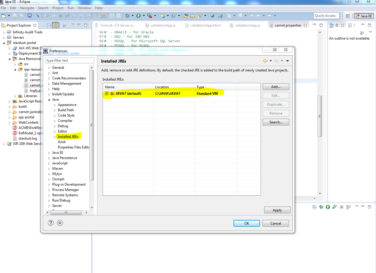

I think your eclipse is using JRE8/JAVA8. can you please configure your eclipse to use JAVA7/JRE7 and check ? After pointing your eclipse to java7 please re-publish web-project/restart server and see if it works.

I installed JDK 1.7.0_71 with JRE 7 and this switch fixed the issue and I was able to complete the tutorial. So, does this mean that the root cause issue is the lack of support of Nashorn JavaScript engine? Anyway, case closed. I really appreciate your help and support.
Thank you very much. Kindest regards.
