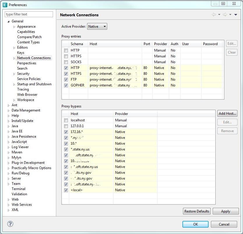

Re: Cannot Access Plugins in Eclipse 4.3.2 [message #1712713 is a reply to message #1712709] Tue, 27 October 2015 11:29 Go to previous messageGo to next message
Looks like there are issues regarding the installation process and there is an update job in the background that doesn't work. At least that is what the log says as it talks about connection timeouts.
Maybe you are behind a proxy and need to configure your network settings in Eclipse accordingly. Window -> Preferences -> General -> Network Connections
Re: Cannot Access Plugins in Eclipse 4.3.2 [message #1712731 is a reply to message #1712713] Tue, 27 October 2015 14:07 Go to previous messageGo to next message
Hmmm... It is possible. In fact, it is highly probable even. (You know how the state is with security.) Let me check the proxy settings in IE and compare them with Eclipse and update it if necessary. I still don't know if this will make any difference with the plug-ins or not, but you never know.
My other thought I just had is could this be a Java issue? If I don't have the right version of Java (or JRE) on my machine, could that be causing it to not work properly? It looks like I have Java version 6, update 31 (build 1.6.0_31-b05) on my work computer. I know my Java level isn't high enough to run the latest and greatest version of Eclipse 4.4.1, but I thought it should be able to run Eclipse 4.3.2. The application itself launches okay, so I would think that it wouldn't even run if I don't have the right version of Java installed, but maybe I'm wrong in assuming that?
Unfortunately, I don't think I can update Java on my computer due to access restrictions and that we have legacy applications that need the older version of Java in order to run. So, if this is an issue related to Java, then I most likely won't be able to fix it by updating Java on my computer.
Re: Cannot Access Plugins in Eclipse 4.3.2 [message #1712734 is a reply to message #1712713] Tue, 27 October 2015 14:30 Go to previous messageGo to next message
Dirk Fauth wrote on Tue, 27 October 2015 11:29
No, I checked all of the network settings and they look good. The proxy is setup the same:
index.php/fa/23760/0/
So, I'm not sure why there would be network connection issues in Eclipse. I checked my supervisor's settings in Eclipse and his are the same as mine. His is working though and we still can't figure out why mine is not working.
(Please note, for security I "airbrushed" out some of the network settings in the picture above, but the settings there are correct for our agency.)
