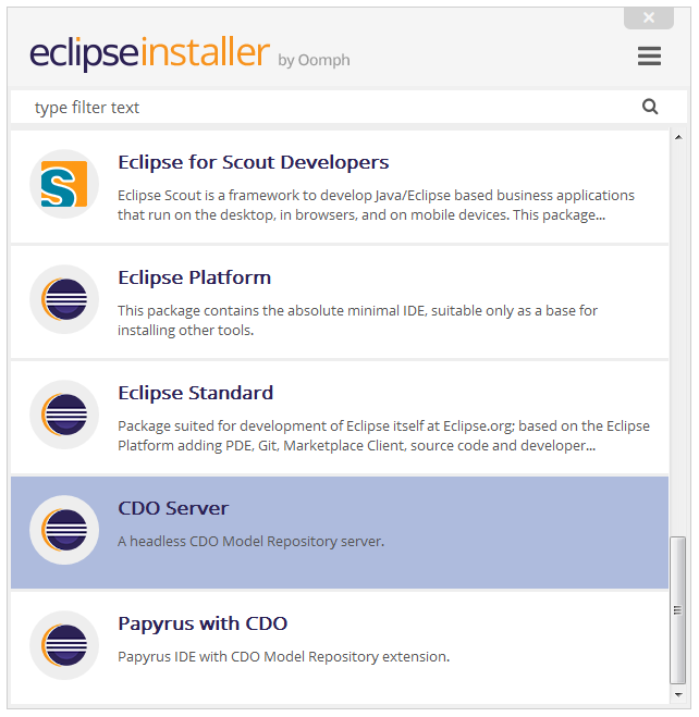

The two example products "CDO Explorer" and "CDO Server" hadn't been
properly maintained for quite a while. Before MArs I noticed that
even our Buckminster build could no longer create them, so I decided
to no longer provde these two products.<br>
<br>
The CDO Explorer is really a a small set of plugins that can be
easily installed into any RCP/IDE product. <br>
<br>
An example CDO Server can now be easily installed with the Eclipse
Installer:<br>
<br>
<img src="https://www.eclipse.org/forums/index.php?t=getfile&amp;id=23744" alt=""><br>
<br>
I hope that helps.<br>
<br>
Cheers<br>
/Eike<br>
