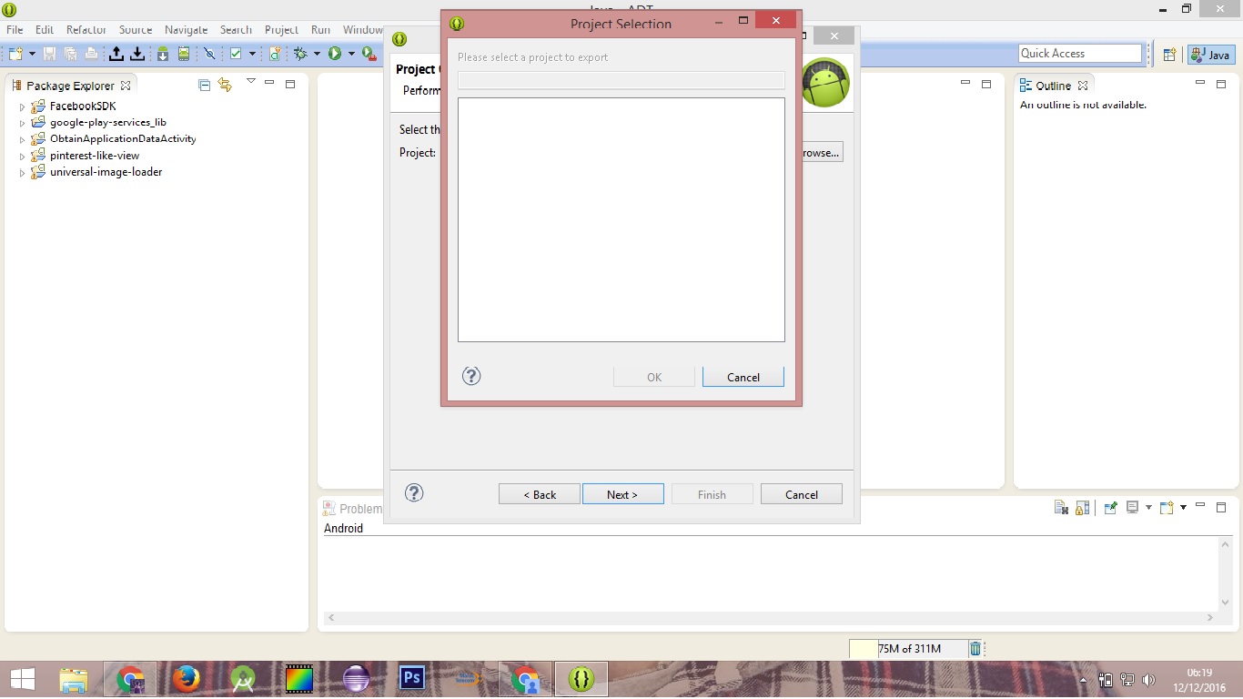

Re: Project Export Errors [message #1749777 is a reply to message #1712372] Mon, 12 December 2016 01:57 Go to previous messageGo to next message
index.php/fa/27835/0/i cant't export the apk file ?? Sad help
Re: Project Export Errors [message #1749783 is a reply to message #1749777] Mon, 12 December 2016 03:11 Go to previous message
Your screenshot does not seem to be related to the Eclipse Scout framework so you are most likely posting to the wrong forum.
In case you are working with the Android IDE based on Eclipse you might want to try one of the places mentioned here.
Please do try to formulate your question with some text as well. Just posting a screenshot does usually not go down well with people trying to help.
