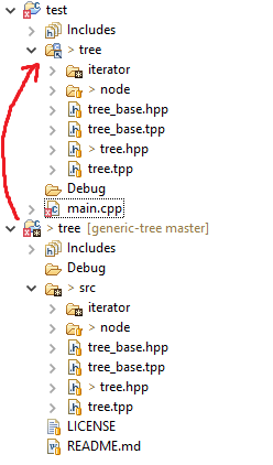

I have a project, B, whos files are located in the git directory and another A project in the workspace. In the project A, I create a new linked folder to the project B. In A, I have a main.cpp file where I include a file from B
#include "B/file.ext"
I also tried to linked folder as source folder and checked the project B in the Project References menu of the project A.
EDIT: I also tried to include a project from the same workspace but also doing so doesn't work.
  • Attachment: Cattura.PNG
    (Size: 16.23KB, Downloaded 413 times)

The makefile is run in your workspace A but A itself doesn't have B so any reference to B will be unresolved. You will need more path information before using B that will find what you are looking for relative to wherever A is physically located. So, it either has to be in the include itself or a path to B has to be given to the compiler (GCC?) often with -I<path>. You don't say who is generating the make file or what you are using to compile/link. Remember, the compiler doesn't know anything about Eclipse. How you tell it where those files are depends on what you are doing and who is generating the make files, etc.
In fact it looks like what you have wouldn't work even if you had complete path information to B as the .hpp files seem to be in B/src (or is it A/src? -- not sure which is A and B in your image).

I'm using CDT Internal Builder.
In the project A (test) I created a linked folder to project B (tree/src).

Think about the difficulty in automating this. I've seen many different placement of header files over the years. In the source directory or in folders named inc, include, hdr, header. Not often, but I've seen combinations of them used concurrently. In your image it looks like you have a directory named "tree.hpp". Does it also contain headers? Asking CDT to figure out which directories you intend to use for your headers is asking a lot.
What you could do perhaps is have a directory somewhere that contains links to your projects so you only need to add a single link to each project. Or, you could separate out the header folders as separate projects as suggested here: http://www.eclipse.org/forums/index.php/mv/msg/68594/215191/#msg_215191
