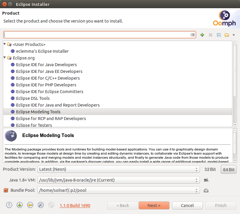

When using the Oomph Installer (1.1. build 1690) to set up the Papyrus (Neon) environment I get some problems.
I'm basing my setup on the Eclipse Comitters product (Neon) and selecting the Papyrus-Main-Infra project, stream Neon/1.2 with target platform Neon.

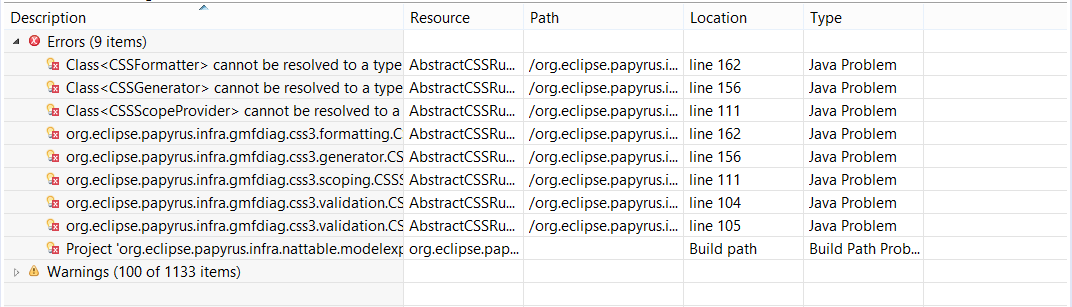

The product is installed and the git repo is cloned and imported into the ws but there are still several errors, see the attached file. Souldn't that be enught to get the environment up? What am I missing?

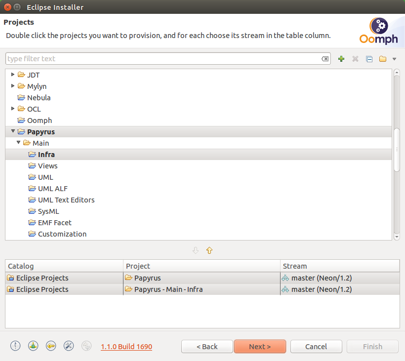

Hi, Patrik,
Did you import the topmost "Papyrus" project? This one must always be
imported, regardless of which (if any) of its sub-projects you import,
because it defines the basic Papyrus run-time dependencies.
Keep in mind that in the Oomph setup, the project hierarchy provides
organization only. There is no inheritance of stuff in containing
projects by contained projects.
> Regards
> Patrik

Re: Papyrus Oomph setup problems [message #1712155 is a reply to message #1712139] Wed, 21 October 2015 10:52 Go to previous messageGo to next message
Thanks Christian, I missed to include the top Papyrus Project
Patrik
Re: Papyrus Oomph setup problems [message #1712508 is a reply to message #1712155] Mon, 26 October 2015 04:54 Go to previous messageGo to next message
Tried it again and still can't get it to work. I get ~100 errors e.g. in ...gmf.codegen (i think)
See the attached images to see my used configuration of the wizard.
What (else) am I missing?
/Patrik
  • Attachment: oomph_1.png
    (Size: 115.31KB, Downloaded 124 times)
  • Attachment: oomph_2.png
    (Size: 74.88KB, Downloaded 130 times)
Re: Papyrus Oomph setup problems [message #1712509 is a reply to message #1712155] Mon, 26 October 2015 04:59 Go to previous messageGo to next message
Tried it and I still can't get it to work. I still get ~100 errors, e.g in ...gmf.codegen i think.
I've attached screen shots of the configuration of the wizard. What (else) am I missing?
/Patrik
    (Size: 115.31KB, Downloaded 116 times)
    (Size: 74.88KB, Downloaded 119 times)

Hi, Patrik,
Sorry about that. The diagram tests in the Neon release now depend on
new test generation bundles that require the GMF Tooling. I have
pushed an update of the setup model that adds this target platform
dependency.
Your next invocation of the Oomph setup should fix you up.
Cheers,
Christian
