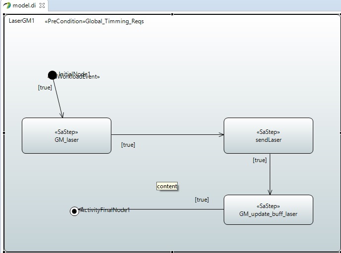

Hello all,
Since that i did not get any answer from you, i suppose that maybe my question was not clear. Meanwhile i have tried to fix the issue intervening into the source code and make an eclipse plugin. I have downloaded the source code of papyrus and i am trying to understand its functionality and structure in order to make the required changes.
Ideally, i would like to doubleClick on the "OpaqueAction" box and then this event would enable a popup window which would allow me to choose from the filtered MARTE stereotypes.
This would be probably solved if i would be able to add an IDoubleClickListener in the UML activity diagrams or even better in the "OpaqueAction" box.
Despite the fact that i have spent much time on this, i did not manage to find where should i include the IDoubleClick listener. A listener should be added on a viewer instance, ie. viewer.addDoubleClickListener(new event){....}.
But i cannot find where is the viewer instance of the activityDiagram or more specifically of the opaque action. Am i correct or am i missing something?
Does anyone know which plugin/ papyrus package is responsible for handling the activity diagram interface?
The last day i was checking the org.eclipse.papyrus.uml.diagram.activity.part.UMLDiagramEditor class and the org.eclipse.uml.diagram.activity.part.opaqueActionEditPart, but i did not figure out any listeners in the code.
Is there any superclass that inherits the initialization of the activity diagrams?
I would be very pleased if you could give me a hint in which package should i look to add a listener in the papyrus activity diagrams? Is it possible to add a listener on a specific activity diagram node (OpaqueAction)
I am uploading also an activity diagram with the stereotyped Opaque actions.
Thank you in advance for your time.
Kostas

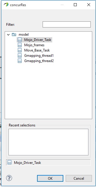

However, i have not managed yet to create the pop up window that will allow me to choose from a list of attributes. I assume there should be a chooser or something in eclipse that could be integrated in a popup window (like the window that opens when someone wants to edit an attribute of a stereotype). Of course the popup window is not a necessity and it could be an integrated in the eclipse views window like the "propterties view" of the papyrus. Is there any plugin that i should focus and check for such a functionality? Then maybe i could extend this plugin based on my needs.
ps: I am attaching a picture of a window that i would like to get, making it easier for you to understand what kind of chooser i would like to have. I should be able to fill the chooser in with elements of my choice.
Thank you in advance.
Kostas
