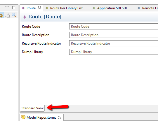

I have created a new custom form based on this tutorial [1]. However, if I include my new viewmodel plugin it does not pickup the new form but shows the Standard View editor instead.

Re: Customer Editor Form [message #1711734 is a reply to message #1711696] Mon, 19 October 2015 09:07 Go to previous messageGo to next message
Hi Wim,
no you do not have to do something sepcial. However, what do you mean by
"Standard View editor"?
Best regards
Jonas

Re: Custom Editor Form [message #1711749 is a reply to message #1711734] Mon, 19 October 2015 09:53 Go to previous messageGo to next message
index.php/fa/23610/0/
This view.
Re: Custom Editor Form [message #1711827 is a reply to message #1711749] Tue, 20 October 2015 01:21 Go to previous messageGo to next message
