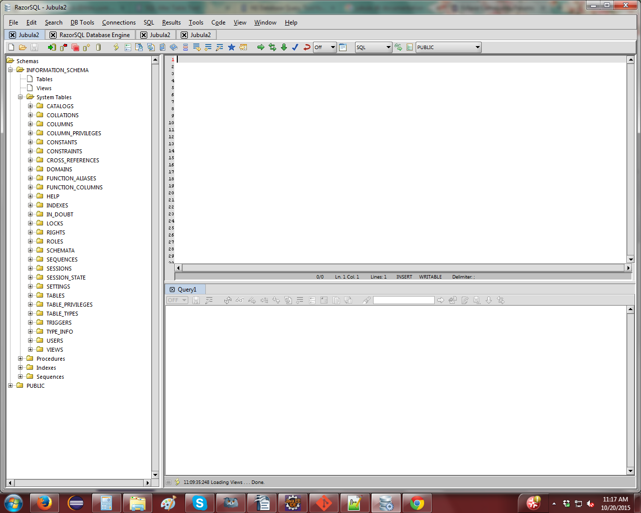

Thanks for ur reply.We are trying to understand how testcases are stored in database.For production we are planning to use other database not h2 as recommended by jubula.
I tried opening the embedded.h2.db file using RasorSQL tool but it shows only the system tables information.We actually want to view the content following db schema ,how testcases are stored,how project details are stored etc.Any help in this will be highly usefull.
P.S : PFA of table sturcture obtained using RasorSQL tool

Sorry, I cannot help you here. We normally do not look at the database directly since the schema is generated by EclipseLink.
To understand how the data is modelled you should take a look at the sources of Jubula. The persistence layer uses JPA annotations on the Java classes. All data classes have names ending ind PO (persistent object). Search the org.eclipse.jubula.client.core bundle for the org.eclipse.jubula.client.core.model package.
Once again: this is not part of a public API and will change between releases!
