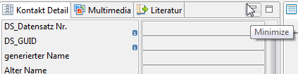

but now i noticed a trivial case where an Menu-Point keeps visible which should not show up with closeable=false
you can 'Minimize' a view in a folderLayout, then you get a quick-toolbar, with an restore button/Icon, and an icon/button for each View.
index.php/fa/23563/0/
rightclick on an icon/button. a context menue pops up giving you the following options:
    Orientation > (with submenu)
    Restore
    Close <- this is just wrong, if closeable is false!
index.php/fa/23564/0/
is there a way i can influence this menu?

No you need to file a bug report so that it can be fixed - to only other
chance I see is to roll your own renderer.

submitted
https://bugs.eclipse.org/bugs/show_bug.cgi?id=479952
