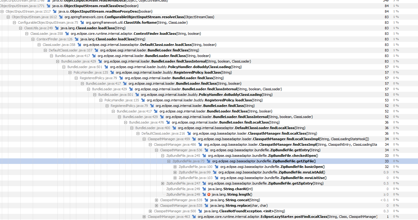

I have an RCP client application based on eclipse 3.7.2. The application make calls to a websphere server using spring remoting invoker.
In this time I am facing a performance issue due to de-serialisation time of the objects results of the remote invocation,
With a java profiler I can see that the DefaultClassLoader open many times the same jar (attache a stack trace for more details) to load the same class.
I am looking for an option to cache loaded classes to optimize classes loading and then de-serialisation time, have you please any idea about that ?

I am not sure that the problem concerns eclipse, but my tests of the same service call with same parameters in my RCP application and in a Unit test shows a big difference between the de-serialisation time of the response Object in both sides.
I am trying to test a couple of eclipse OSGI options like osgi.framework.activeThreadType , osgi.bundlefile.limit for the moment with no impact.
In the same time I am looking for JVM (oracle 1.7) options that can optimize classloading.....
