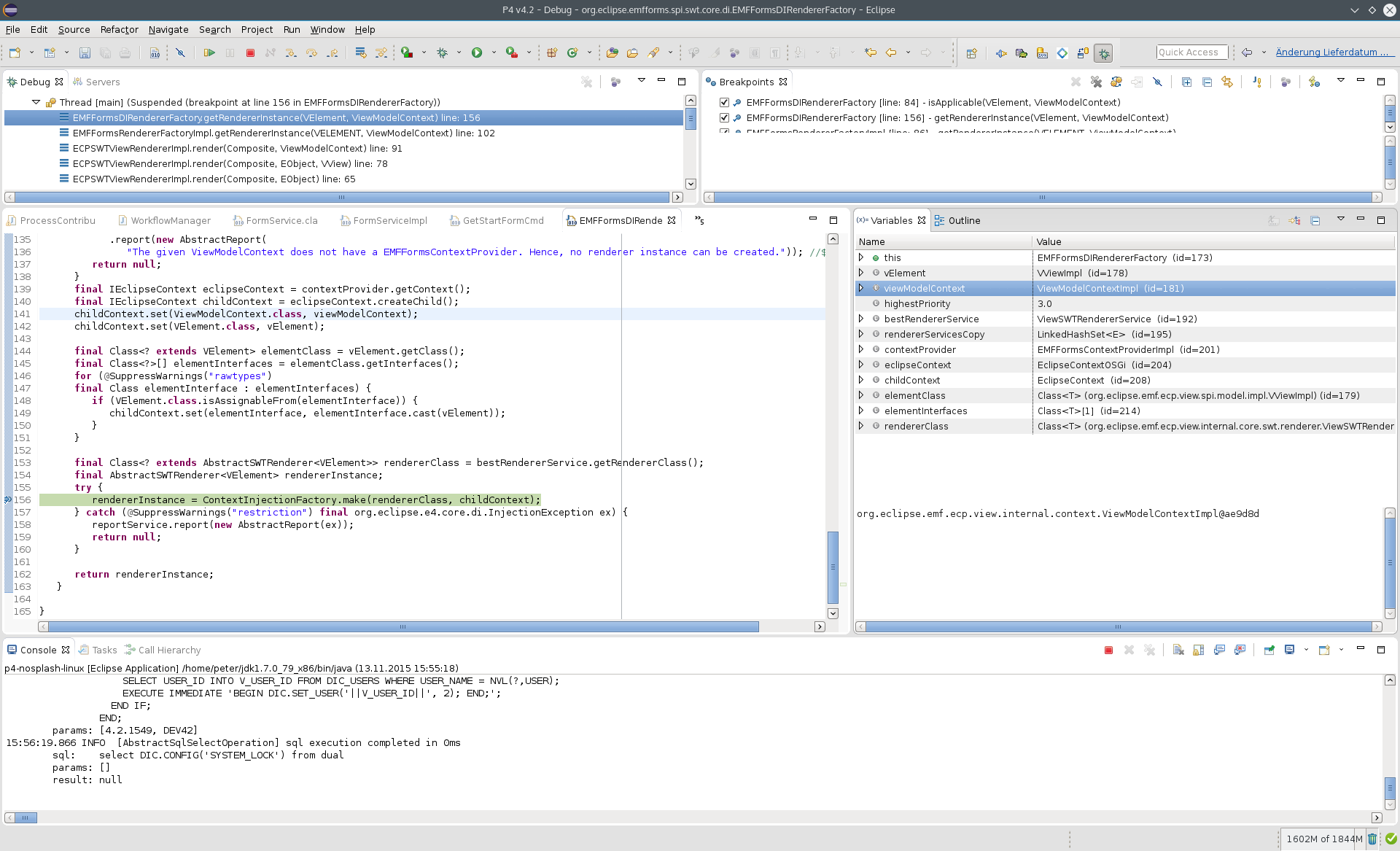

Can you please set a breakpoint in
org.eclipse.emfforms.spi.swt.core.di.EMFFormsDIRendererFactory.getRendererInstance(EMFFormsDIRendererFactory.java:156)
and check whether vElement and viewModelContext in line 140 and 141 are not null.
Cheers,
Eugen
Re: [EMFForms] Dependency Injection fails on render of view [message #1714561 is a reply to message #1714526] Fri, 13 November 2015 10:03 Go to previous messageGo to next message
Hi Eugen,
both of these Objects are not Null. See Screenshot below
childContext.localValues has the following content:
{org.eclipse.emf.ecp.view.spi.model.VElement=org.eclipse.emf.ecp.view.spi.model.impl.VViewImpl@b4ca64 (name: null, label: , visible: true, enabled: true, readonly: false) (ecorePath: null), org.eclipse.emf.ecp.view.spi.context.ViewModelContext=org.eclipse.emf.ecp.view.internal.context.ViewModelContextImpl@ae9d8d, org.eclipse.emf.ecp.view.spi.model.VView=org.eclipse.emf.ecp.view.spi.model.impl.VViewImpl@b4ca64 (name: null, label: , visible: true, enabled: true, readonly: false) (ecorePath: null), parentContext=OSGi context for bundle: org.eclipse.emfforms.swt.core.di}
Thanks for helping out!
Greets, Peter

  "No bundles using service."
From the debug output of my previous code, I think that not all services are in the provided context. And the services are not being bound: "No bundles using service"
Maybe a problem caused by not running on Eclipse 4? (but on the other hand "some" Objects are in the context ....)
Any Hint on where to go on?
Thank you very much for your help!
Greets, Peter
additional debug output:

Re: [EMFForms] Dependency Injection fails on render of view [message #1714746 is a reply to message #1714709] Mon, 16 November 2015 06:44 Go to previous messageGo to next message
can you try add the javax.inject bundle explicitly to the run config?
Cheers,
Eugen
Re: [EMFForms] Dependency Injection fails on render of view [message #1714748 is a reply to message #1714746] Mon, 16 November 2015 06:52 Go to previous messageGo to next message
osgi> ss inject
"Framework is launched."
id	State       Bundle
50	RESOLVED    javax.inject_1.0.0.v20091030
osgi> diag 50
reference:file:/home/peter/workspace-v4.2/.metadata/.plugins/org.eclipse.pde.core/.bundle_pool/plugins/javax.inject_1.0.0.v20091030.jar [50]
  No unresolved constraints.
Still same error: Quote:
org.eclipse.e4.core.di.InjectionException: Could not find satisfiable constructor in org.eclipse.emf.ecp.view.internal.core.swt.renderer.ViewSWTRenderer
Re: [EMFForms] Dependency Injection fails on render of view [message #1714764 is a reply to message #1714748] Mon, 16 November 2015 08:50 Go to previous messageGo to next message
we found an error on our side. We are missing an explicit dependency to javax.inject. This leads to broken run configurations in some cases.
We will create a 1.7.2 hotfix release today.

Re: [EMFForms] Dependency Injection fails on render of view [message #1714766 is a reply to message #1714764] Mon, 16 November 2015 09:26 Go to previous messageGo to next message
Thanks for the feedback!
Adding the property to my launch configuration does not seems to work. It prevents the whole app from starting. The diag output from the failed start is something like this:

BTW: out ExecutionEnvironment is 1.7
When analyzing the target platform all the packages(javax.crypto,javax.crypto.spec,org.xml.sax,javax.xml.parsers) are listet as "provided by the JRE"
So I'll wait for the Hotfix release and will give that a shot.
Thanks you!
Greets Peter
Re: [EMFForms] Dependency Injection fails on render of view [message #1714767 is a reply to message #1714764] Mon, 16 November 2015 09:27 Go to previous messageGo to next message
one more thought.
Can you check whether you have a bundle which exports javax.inject ?
Cheers,
Eugen
Re: [EMFForms] Dependency Injection fails on render of view [message #1714768 is a reply to message #1714767] Mon, 16 November 2015 09:36 Go to previous messageGo to next message
Sure as described in one of my former replies: https://www.eclipse.org/forums/index.php?t=msg&th=1071223&goto=1714748&#msg_1714748
The bundel is called javax.inject and has Version 1.0.0.v20091030 and is from http://download.eclipse.org/tools/orbit/downloads/drops/R20140525021250/
