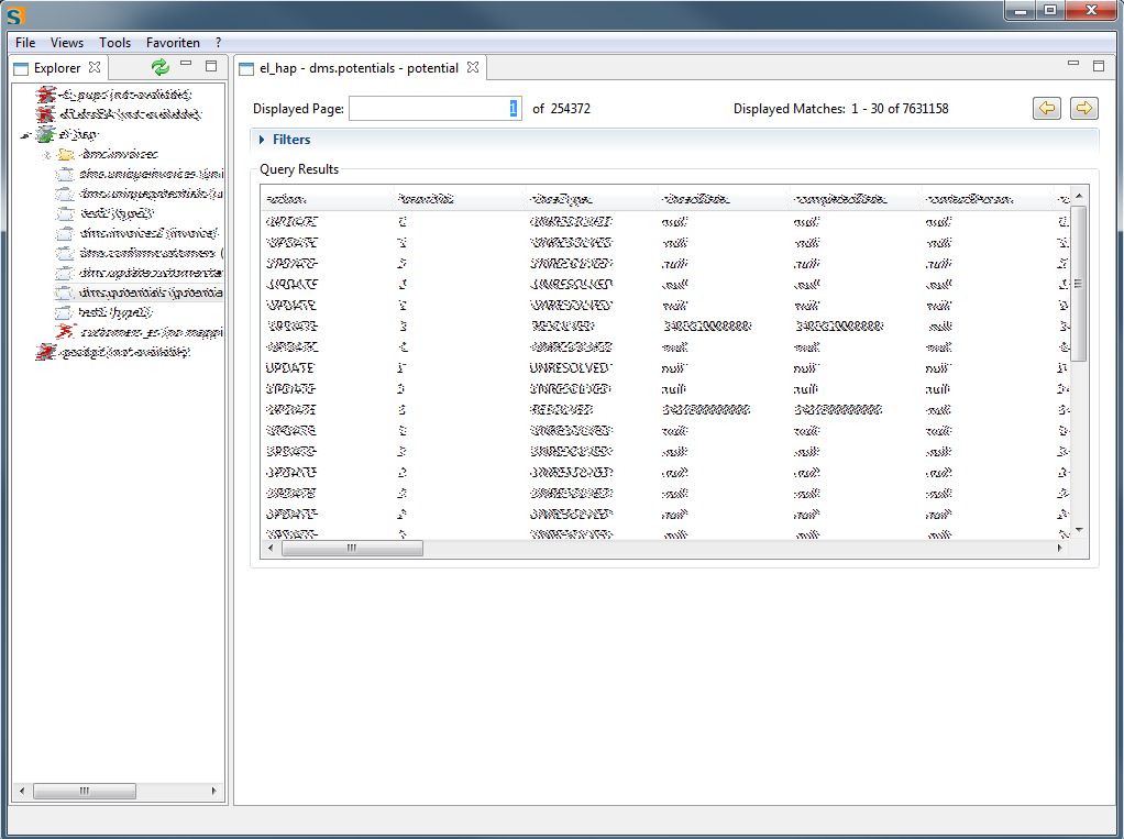

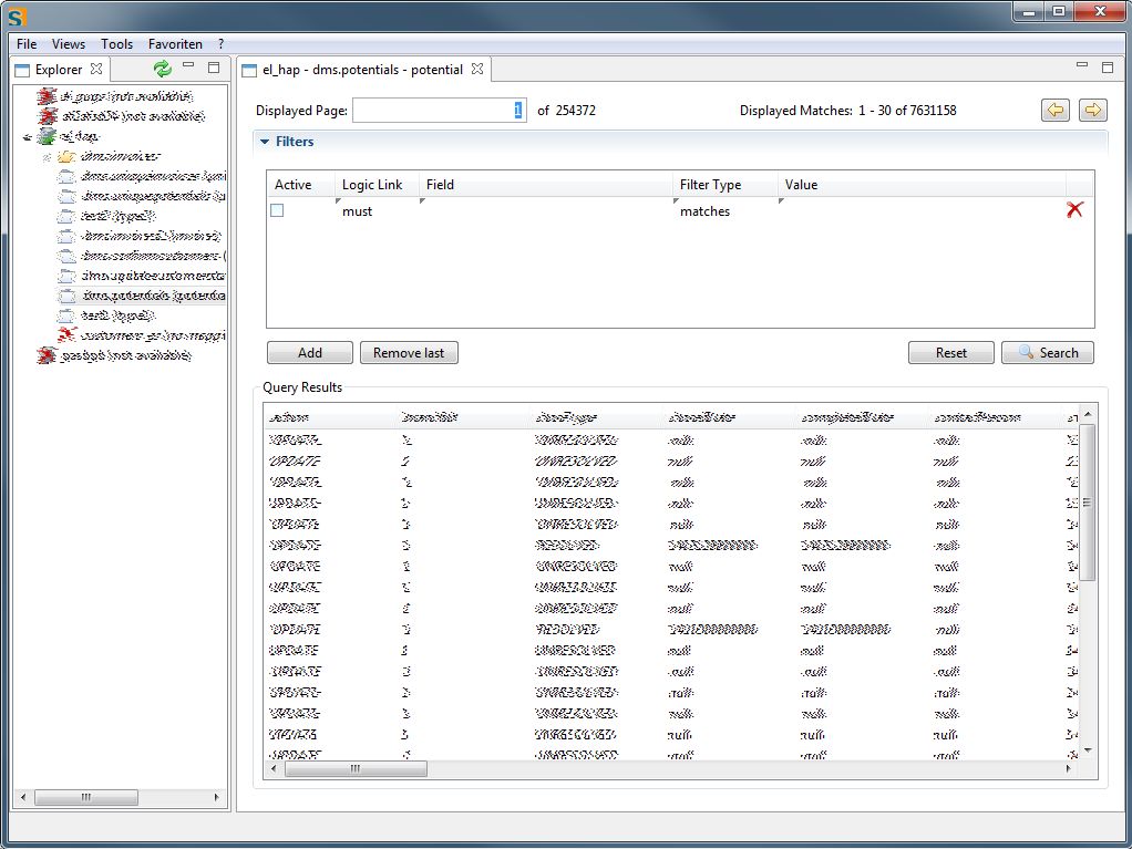

Filters-GroupBox closed:
index.php/fa/23530/0/

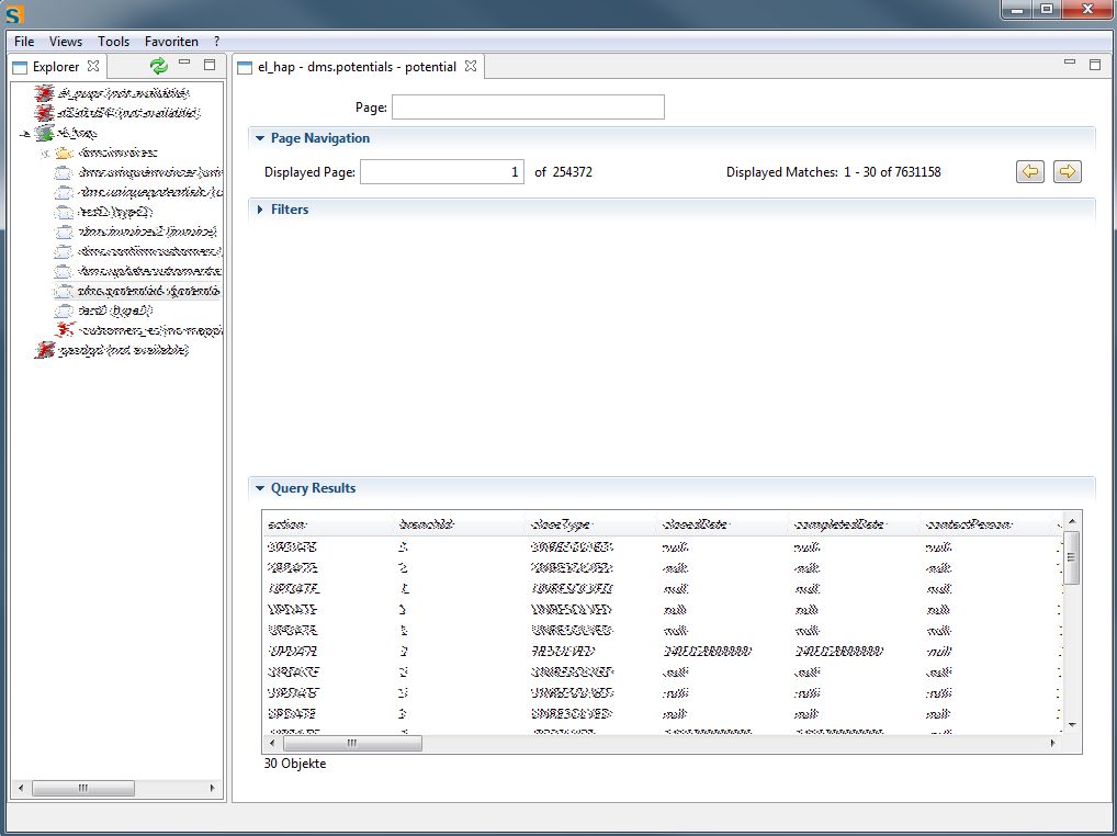

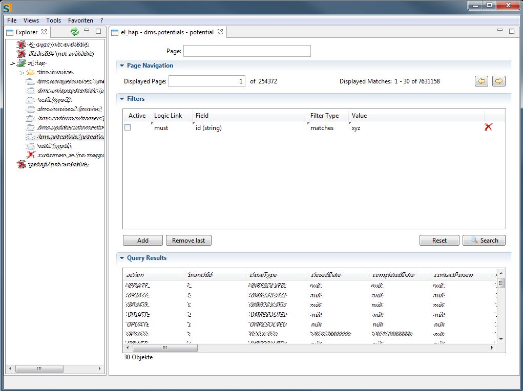

Filters-GroupBox expanded:
index.php/fa/23531/0/
As you see above, one of my problems is, that GroupBoxes that contain a TableField take almost the same space when they are not expanded as when they are expanded. I want to have a behaviour similar to that of an accordeon panel with expandable GroupBoxes.
With 'normal' fields this approach works: For example, if the page navigation GroupBox is closed, the filters GroupBox moves up since the space of the controls in the GroupBox is released.
In contrast, GroupBoxes containing Tables always take a lot of blank space although they are closed. The same happens with the 'Query Results'-GroupBox at the bottom.
Probably I'm just missing a simple property once again, but I have not been able to figure it out so far.

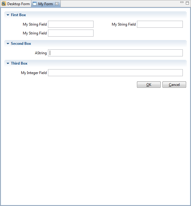

If you have only simple fields (height == 1) in your form, the layout manager works as you expect:
index.php/fa/23532/0/
=> If you close the section "Second Box", you get the result you want.

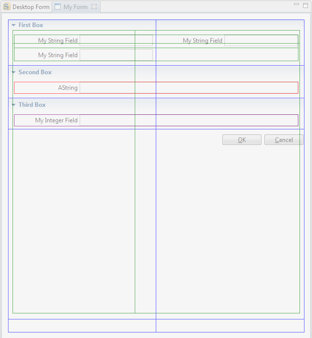

By the way, the layout is grid based. You can inspect it with the Layout Debugger.
index.php/fa/23533/0/

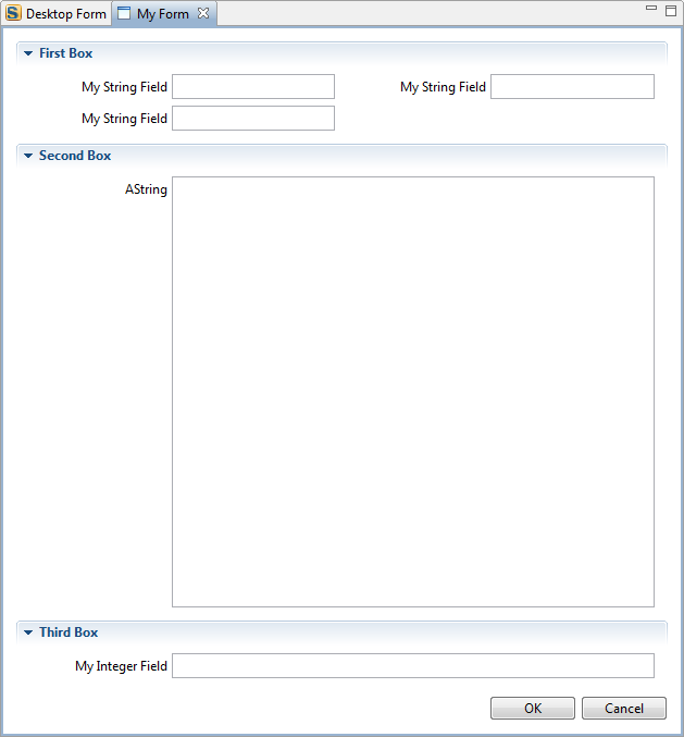

Now let change the AString field to a multiline text field:
- getConfiguredGridH returns 5
- getConfiguredGridW returns 2
- getConfiguredMultilineText returns true
By default, the Scout Layout manager tries to consume all the available space. Multiline fields (like StringField in this example or a TableField in your example) will be stretched out.
index.php/fa/23534/0/
I agree with you, in case this field is inside an expandable GroupBox this is not really looking good. Because as you noticed, if the GroupBox is collapsed the unnecessary space is still present.

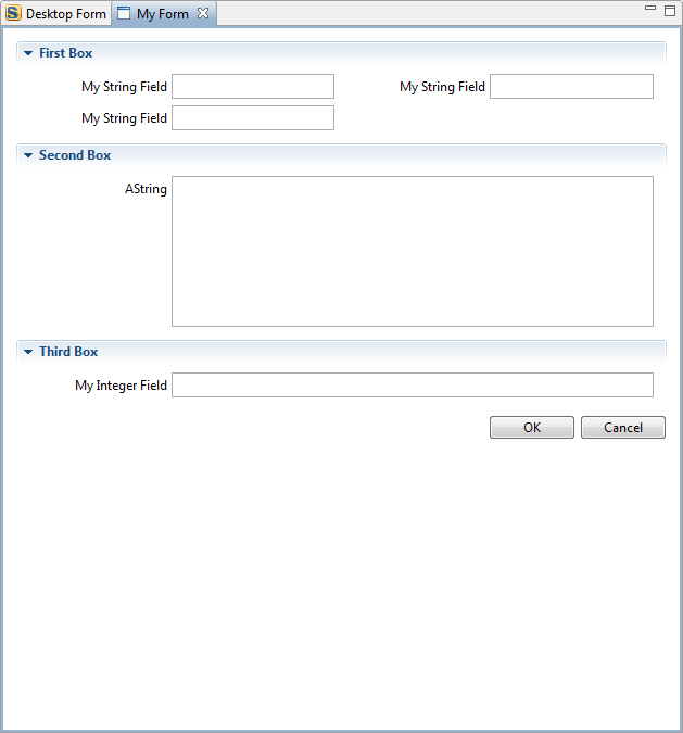

You can tell the MainBox of your form that it should not expand.
Add "getConfiguredFillVertical returns false" im the MainBox of your form.
For my simple example it produces the expected result:
index.php/fa/23535/0/
When I now close my "Second Box" section, I get the result you expect.

Hi, Jeremie and thank you for your answer.
I've been playing around for hours now and still have no sufficient solution. Setting 'fillVertical' of the MainBox to false was a really good hint, but brings along other problems.
For some reason, only the scrollbar of my results table is visible. My tables columns are injected at runtime and the data is first loaded after initialization with reloadTableData from the outside of the class, so it could be that the table is empty when the layout manager tries to calculate the size. Setting GridH to an appropriate value, makes it bit better, but shouldn't be the last solution, as the table then always stays the same size.
Apart from that there are several other problems which would take to long to explain right now.
So I'm trying to explain what I want to achieve and maybe you could give me some more hints how to get there.
index.php/fa/23549/0/
index.php/fa/23547/0/
index.php/fa/23550/0/
As you might see in the screenshots, I deleted the Paging GroupBox and set the ResultsTable GroupBox's expandable property to false. This way I think it's a bit easier as there is only one expandable box left and it also saves some space.
My aim is to make the table always consume the space that is visually available. So when the Filters-Box closes, the table should grow and when Filters-Box expands, the table should shrink. The Filters-Box could have a hardcoded size. Optionally it would be great if the user had the opportunity to set the space ratio between the Filters-Box and the Results-Box via a SplitBar or something like that.
I really would appreciate some quick help, but I believe it's rather a lasting tinkering exercise.
Slightly different topic: Including the help of the layout debugger, I found out that Buttons are treated in a complete other way than Labels when you put them in a GroupBox. I was not able to move the Buttons on top of the Filters table unless I put them in an additional SequenceBox. When wrapped by a SequenceBox, the layout was totally different from when I put them directly in the GroupBox: All buttons aligned to the left side; Button widths all varying depending on the label size. In comprison to that, additional labels where arranged as supposed.
I believe, I haven't properly understood the idea of the layout concept. It's quite different to common UI concepts though...
Jannik

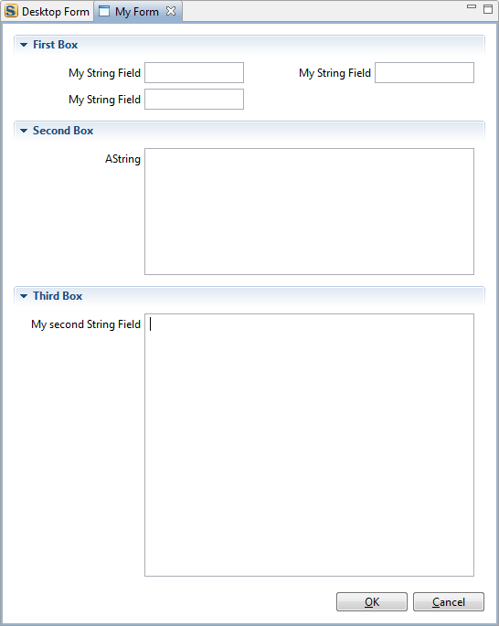

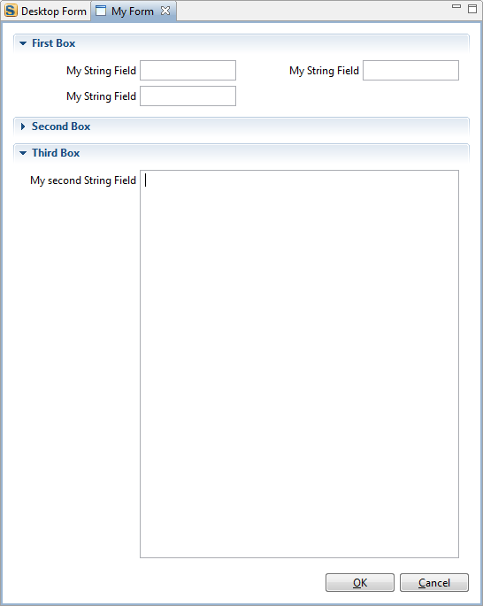

Another property I did not explain in my previous message is GridWeight (GridWeightY for the vertical direction and GridWeightX for the horizontal direction). When the MainBox allows the field to be stretched ("getConfiguredFillVertical returns true" - this is the default), with the GridWeight properties you can influence how the multiline fields will consume the available space.
In my new example, I have two multiline fields. I have set GridWeightY like this:
* AString: "getConfiguredGridWeightY returns 0.0" (none of the available space will be consumed)
* My second String Field: "getConfiguredGridWeightY returns 1.0" (all of the available space will be consumed)
I think this is what you want:
index.php/fa/23560/0/
index.php/fa/23561/0/
