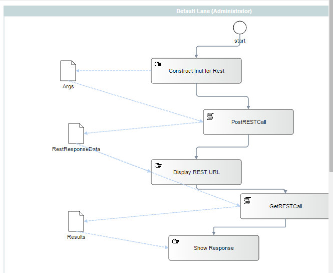

PFA model having RestFul service calls(GET/POST) using Stardust camel application. In the attached model i am consuming rest services which accepts content-type as "application/xml". For JSON it should be "application/json"
As diplayed in below process flow:
1. PostRestCall activity starts Stardust process using POST Restful call.
2. GetRestCall activity makes the GET Restful call to get the stardust process response.
You can use this example as a reference to consume your REST calls
