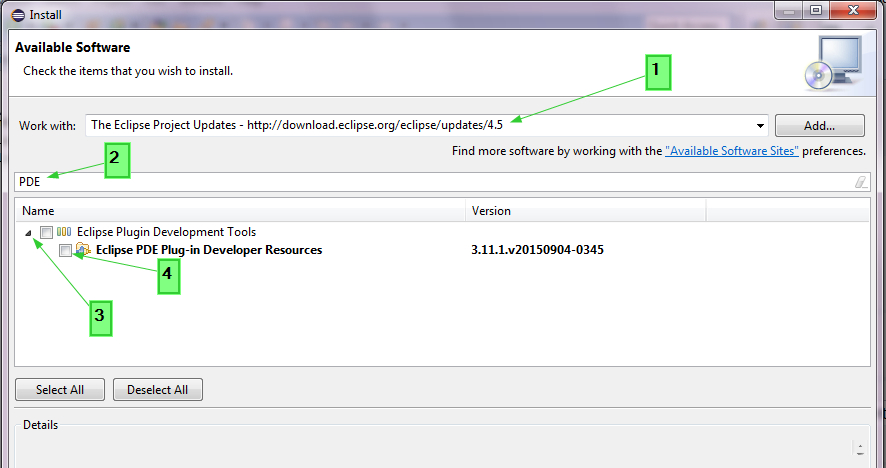

Re: Why do I only have "Custom plug-in wizard" in my list of available plug-in templates? [message #1711165 is a reply to message #1711163] Tue, 13 October 2015 12:04 Go to previous messageGo to next message
Use the following update site.
http://download.eclipse.org/eclipse/updates/4.5
Filter on the string "PDE"
Expand the "Eclipse Plugin Development Tools" option.
Check the sub-option "Eclipse PDE Plug-in Developer Resources"
Download and install.

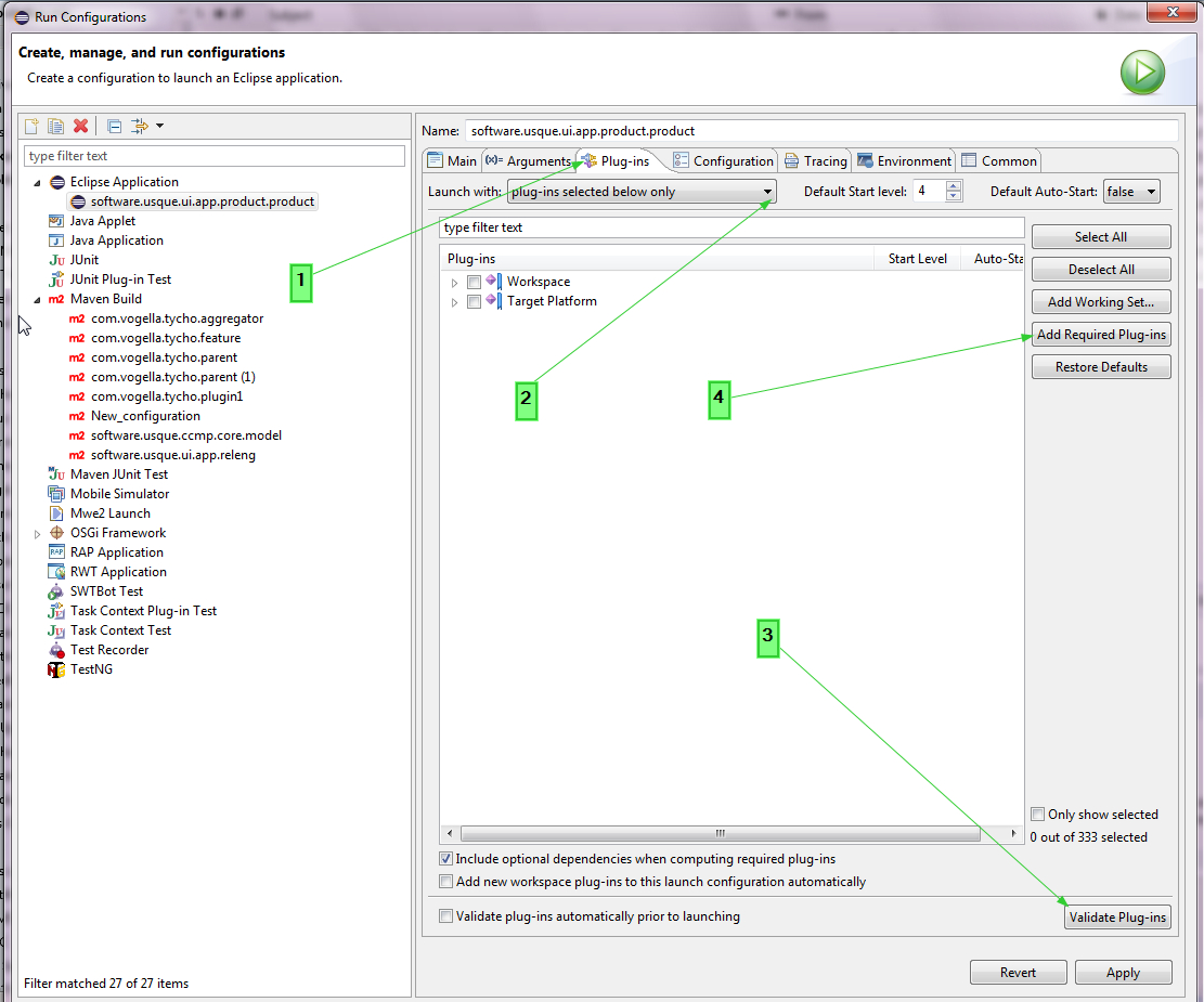

Re: Why do I only have "Custom plug-in wizard" in my list of available plug-in templates? [message #1711171 is a reply to message #1711169] Tue, 13 October 2015 13:32 Go to previous messageGo to next message
From the Run Configuration panel...
index.php/fa/23523/0/
Expand "Workspace" and "Target Platform" to select the plugins as appropriate for your app. Then try "validate plug-ins" then try "Add required Plug-ins". See what that does to solve the missing class.
